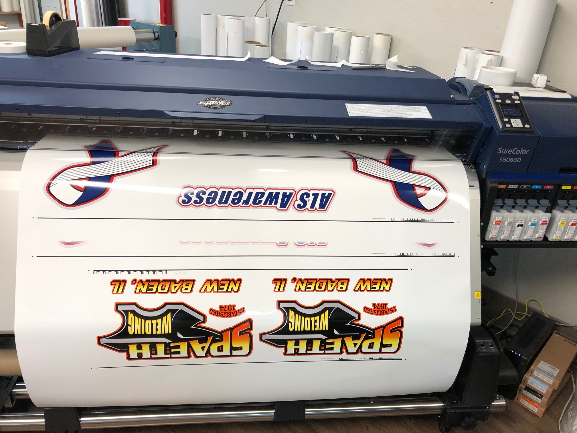

Hello all, I thought I remembered seeing a post a while back with someone having a similar issue. I can print multiple jobs no problem, but it seems like about every +/- 20 prints, it will print a few inches and then stop printing and onyx shows "Could not open TCP/IP connection to 192.168.1.44''. Sometimes I can click refresh a few times and it connects back up, other times I have to restart onyx and/or the printer. Luckily it has only done it within the first 12'' of a print and not in the middle to end of it. Please let me know if you have encountered this problem or if you have a solution. Thanks in adva
