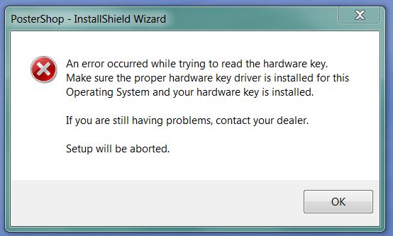

    I've tried it on an XP Machine and I get a message about the key not being compatible. I went to onyx's website and found an updated driver for Windows 7 but i'm still getting this error. See image.

    Do you have the HASP driver for the dongle?

    I downloaded the HASP driver from Onyx's website. I don't think the key got damaged but I wasn't up there when they packed up the printer and brought it back to our shop. Actually they forgot to give us the dongle and they shipped it to me UPS and it came in a very well packaged box I don't think it would have been damaged from shipping. Version 7 says I don't have the right key, will I need to get a new key from my dealer or can they just update the one I have now?

    Okay Onyx was a huge help they sent me the key update and I was able to get 7.3.2 installed.
