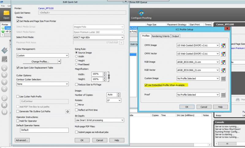

    Hi guys, I have a big Q and haven't been able to figure it out. Some of my images need to be printed in sRGB, some in ProPhoto and some in AdobeRGB. I configured the default quickset to use sRGB as the RGB Image/Vector profile and checked the 'Use Embedded Profile when Available' checkbox.
    I expected the RIP to use the embedded profile but if I send a ProPhoto tagged document, the results are disastrous. In an effort to work around the issue, i've created quicksets for adobeRGB and ProPhoto to get around the issue.
    What is the best approach? Am I reading the issue incorrectly? Screenshot below, please advise - tx!

    Given that the settings you've showed should work, I'm wondering just what you mean here.
    sRGB, ProPhoto, and Adobe 1998 RGB are all working spaces, not printing spaces. So none of your images are ever going to be "printed in" those spaces. They're always going to be converted from those spaces to the final printer color space -- which is your printer profile.
    And for that to work, your images have to be created in those spaces, not just tagged as them.
    So basically, it'd take more info to figure out what's going on, because if you're creating your files correctly, again, the settings you're showing should work.

    When you say images are you referring to tifs and jpgs with embedded profiles? Most RIPs honor these, but I have seen many RIPs that do not honor embedded profiles on PDFs.
    If you are embedding your RGB working spaces and the RIP is not recognizing them as the input profile than yes you are going to have to create a quick set for each or for each job go in and edit the input profiles.

    Gents, tx for your respones!
    All of my images are JPGs in SRGB. I'd like to offer pro clients the ability to print images that have been edited in ProPhoto or AdobeRGB. I thought Onyx Thrive would pick up the different Embedded profile and use it prior to sending to the output profile, but it appears that functionality is not working in my workflow. As dypinc suggested, I've gone with quicksets for each environment.
