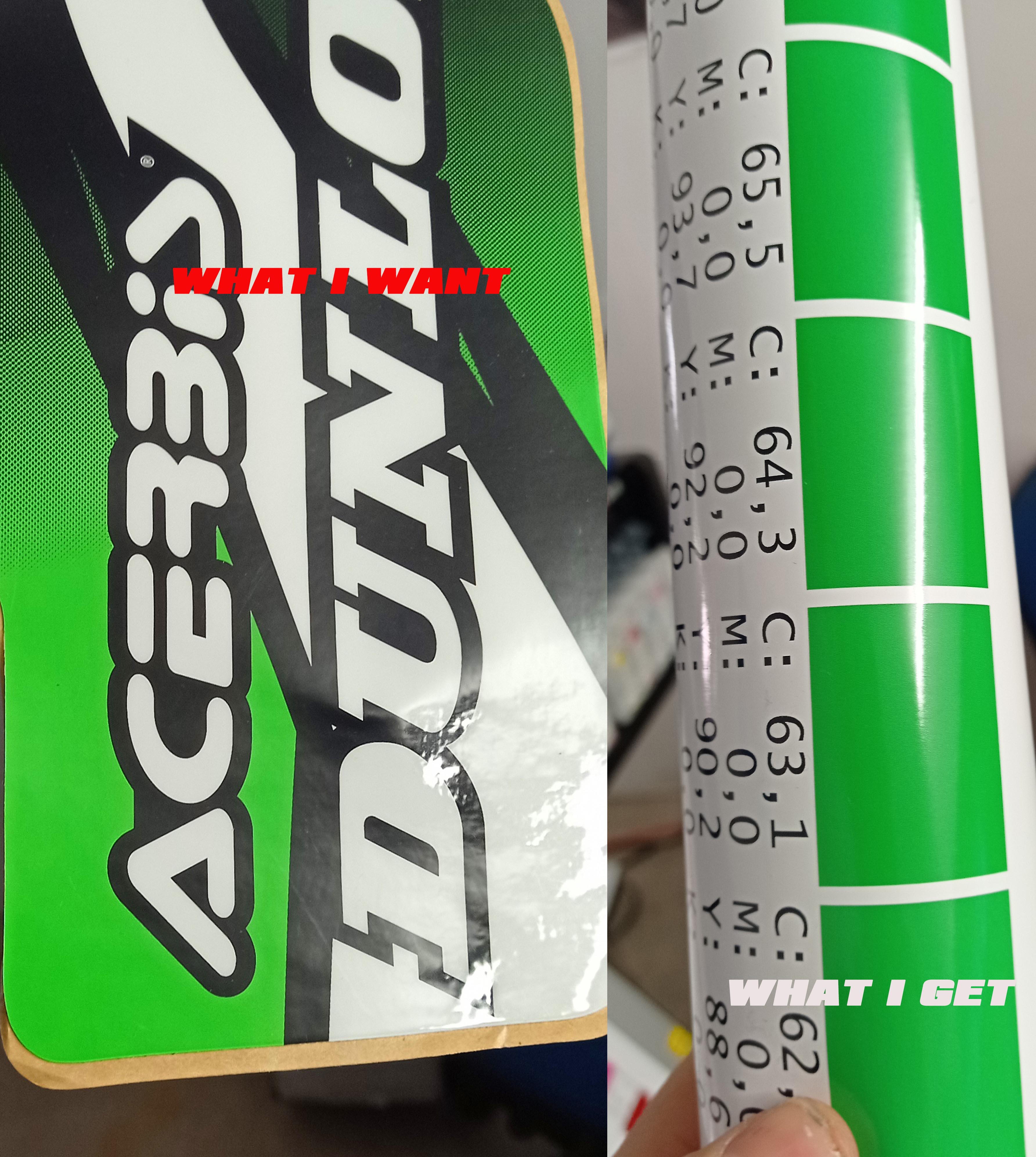

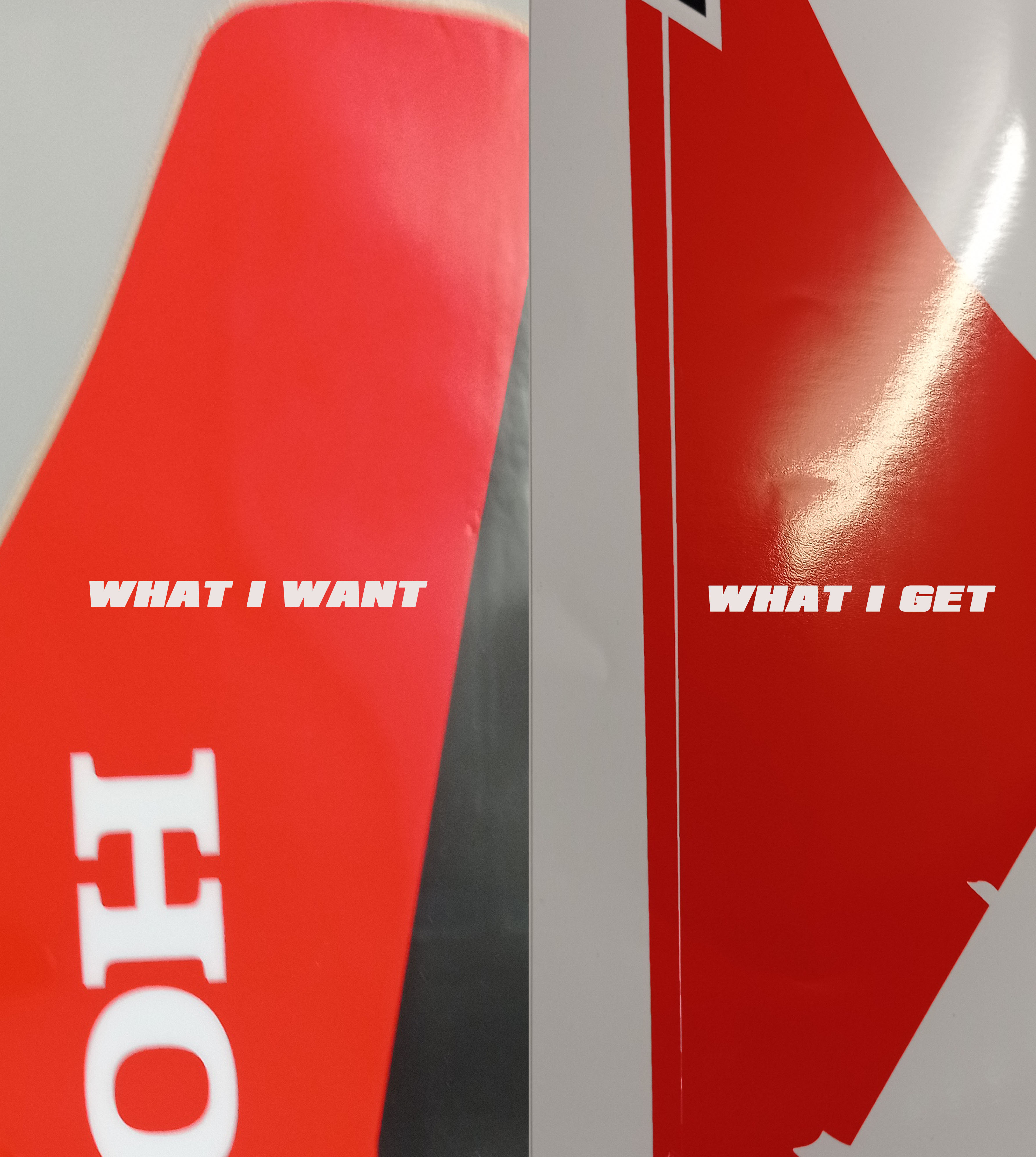

Here are pictures of what i want and what i get, i use the CMYKORdefault ICC and i can't get them with Swatch Books trying every settings . The Bright RED i want is always bloody or too orange. The GREEN i get is always poor in brightness.

You're never going to achieve a green that vibrant without a dedicated green ink channel, which the S80 doesn't have.
You should be able to get a little bit closer to the Honda red though. I'm pretty sure we've matched it before on some jobs.

Oh that's pretty bad news for the green. ONYX support told me to try to save files in RGB and print. If you have an idea to match the Red closer please do tell me.

Yes, using RGB files you will get brighter colours, so that should help with your reds. To be honest, your greens look very good, so I'm not sure you'll get any closer.
We print RGB 255,0,0 to get the brightest possible reds.
