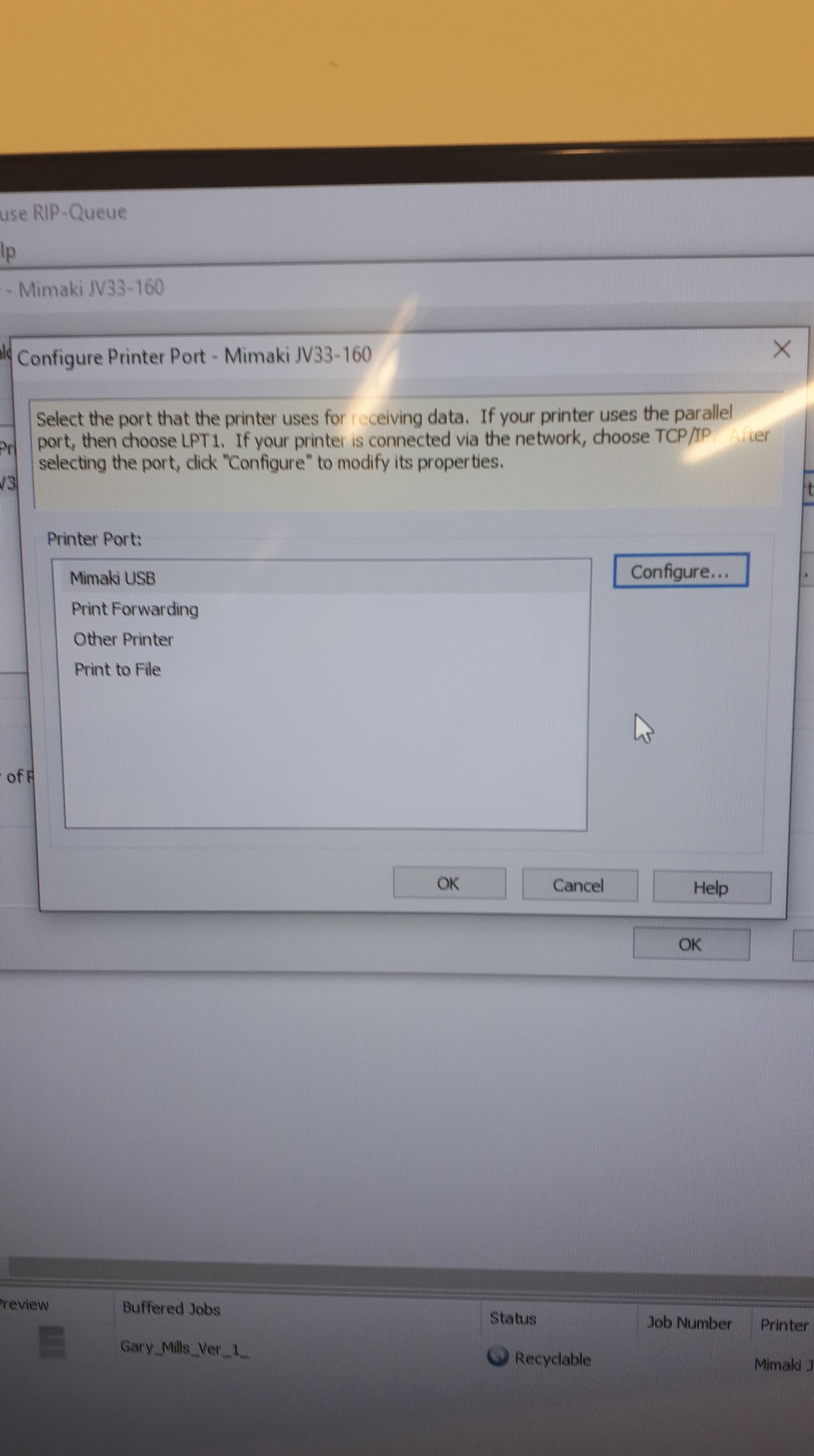

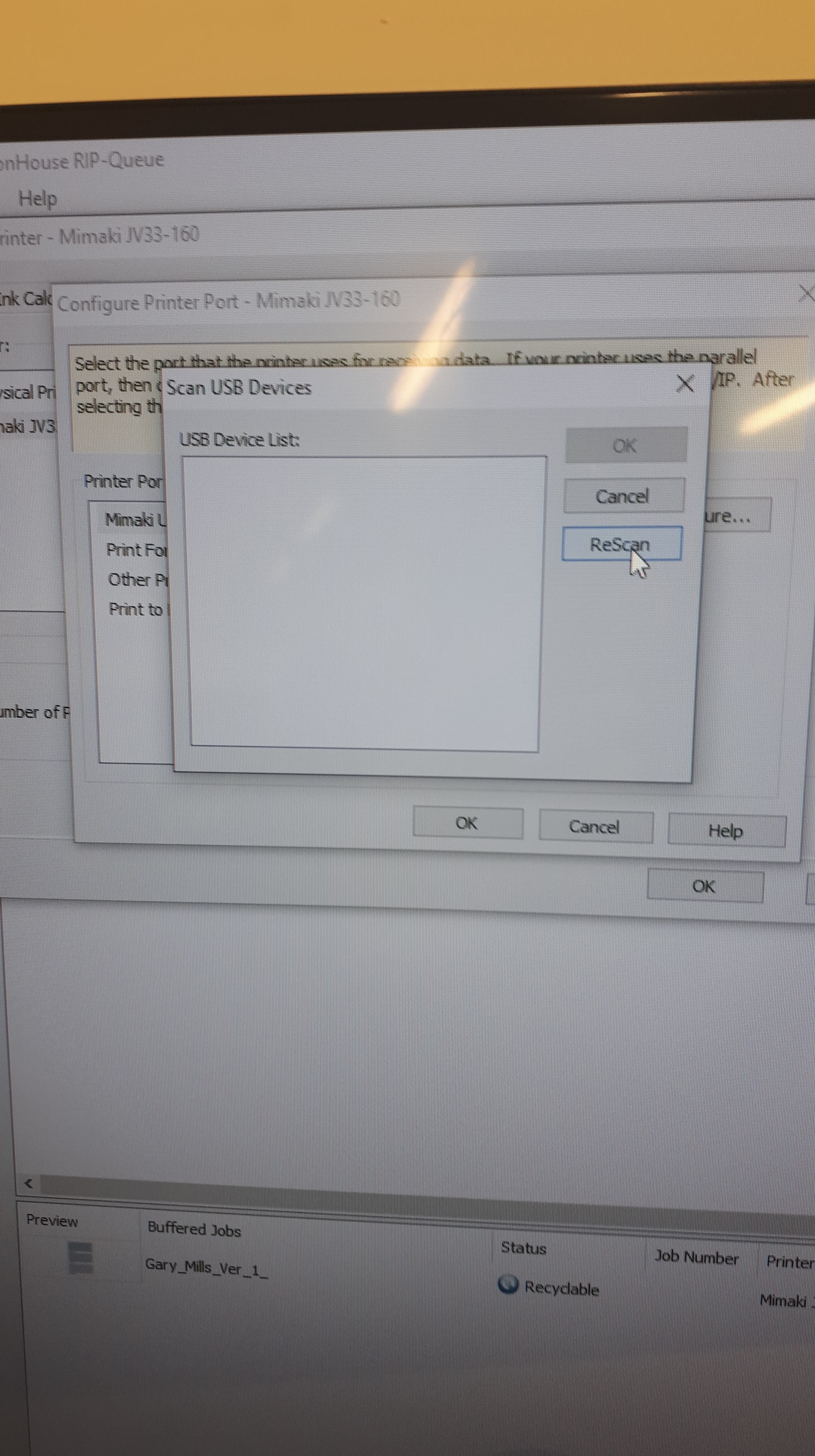

Hi All,
I am after some knowledge regarding connecting a Mimaki JV33 - 160 connecting to onyx rip using a usb cable.
I simply cant get it to show up on the configure printer section when selecting USB.
I would like it to be used through onyx so I can start using print and cut...
I have added some photos of the onyx usb section
Kind Regards,
Andy

You need to install the Mimaki USB driver before the computer will recognize it. It's available on their site.
Edit: I responded before the pictures. Make sure it's the latest version as the driver is glitchy on older versions especially if you installed it from a CD. The download is the better option.
andytoner
Thank you for the info.
Well I uninstalled the printer and now I cant even see it in onyx or load it back up......... Messed it right up as they say....
