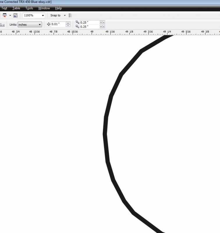

The screenshot mainly shows what I am trying to do, I know Flexi has optamize by curve tool . But I see nothing like that in corel .
When my printer does the contour cut you can imagine how this looks.
Anyone have a simple fix ?

delete the nodes, leave two or three only, Bezier tool - drag the handles till you get what you need. Easy.
