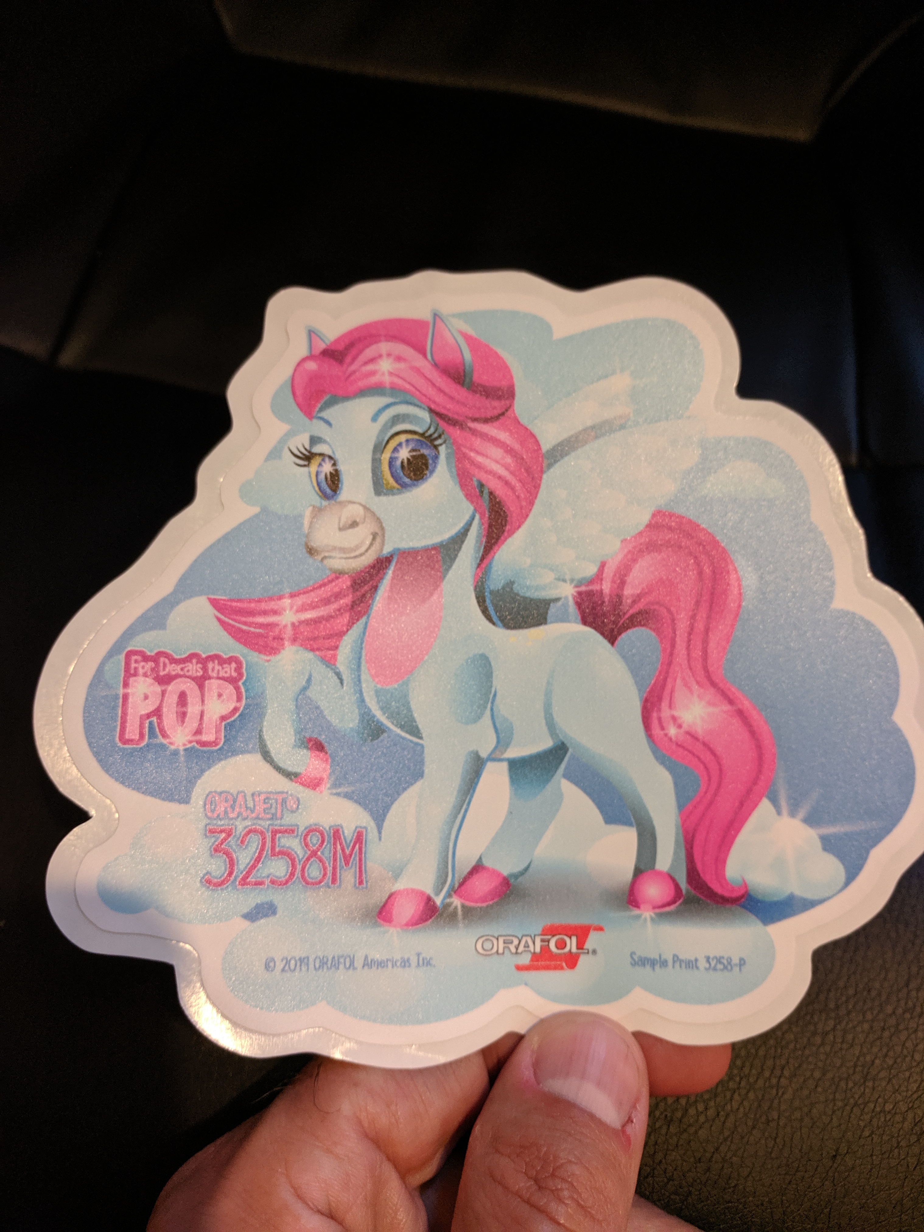

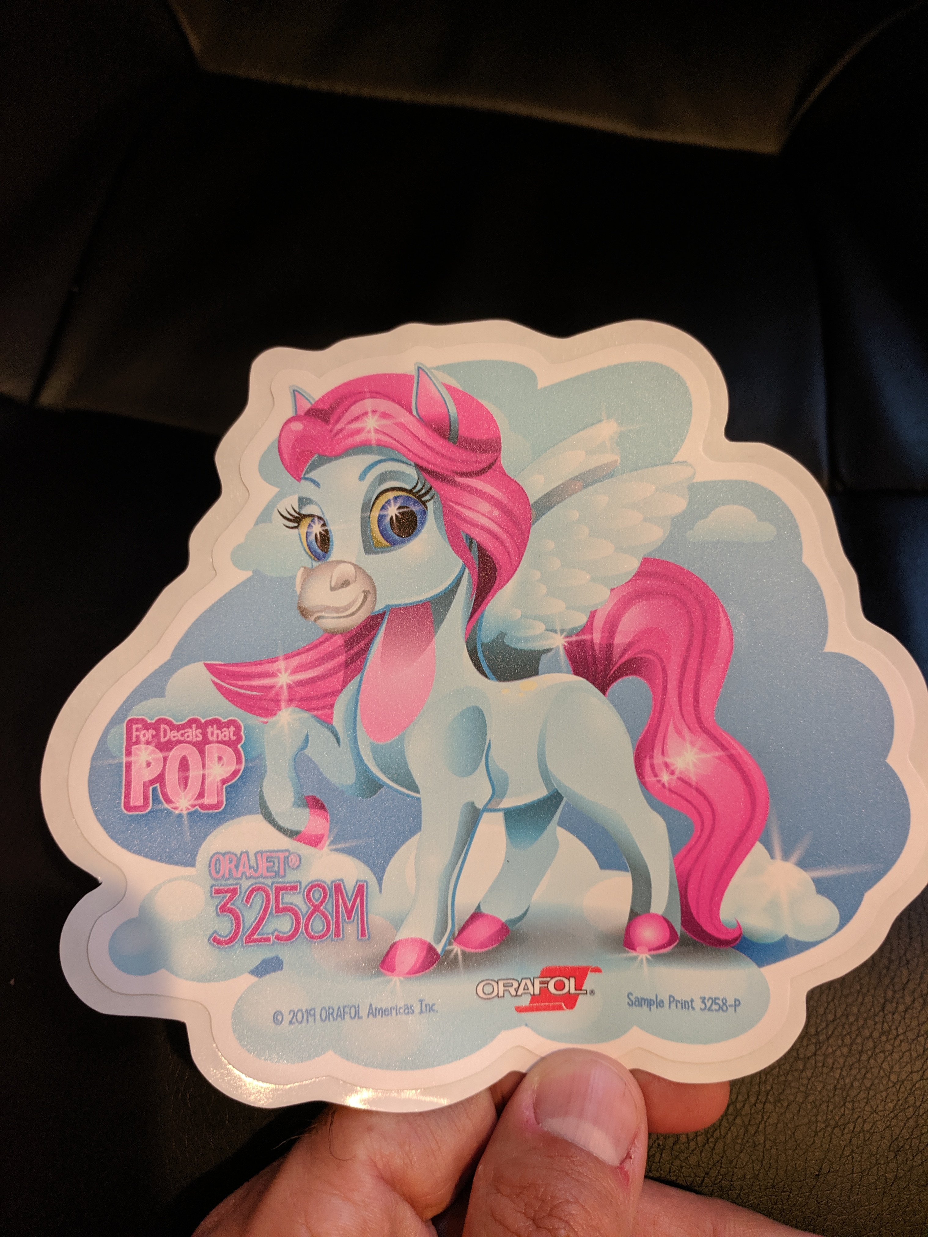

Oracal sent me a printed sample of their new 3258 sticker/decal vinyl, stuff looks pretty good, but I'm more impressed with the print quality.
Anyone have someone on the inside at Orcal that can find out what printer they used to print these samples on?
Also, I can't tell if this is laminated or not, anyone else get the sample that can tell if has an overlam on it or not?

Evan Gillette
My sample was just a print and contour of the Orafol logo, not particularly impressive in the quality department but not bad either. Pretty standard quality for a newer uv. Mine is not laminated, different texture between printed area and un-printed media. It does seem like a good option for cheap decals though, nice and rigid.
Wonder why they didn't send everything the pony and did some of just the logo, that's odd.
Not sure mine is UV printed, the ink doesn't feel raised.
