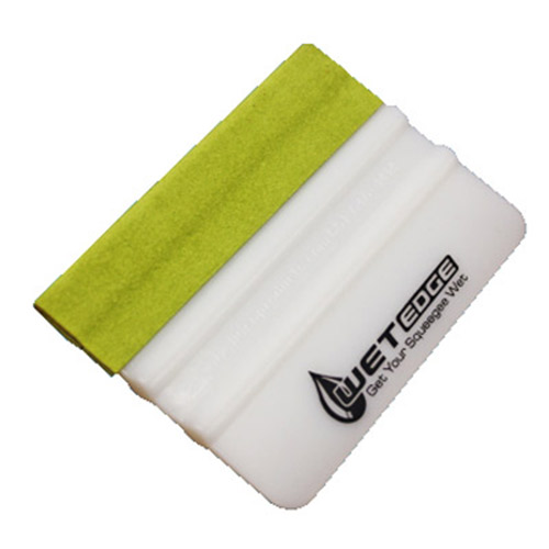

:goodpost:All good points above, I highly recommend using Rapid Tac application fluid for Oracal 3850.
I use a microfiber covered squeegee saturated with Rapid Tac fluid to eliminate surfaces scratches.
