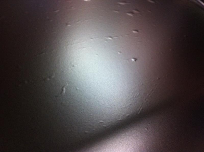

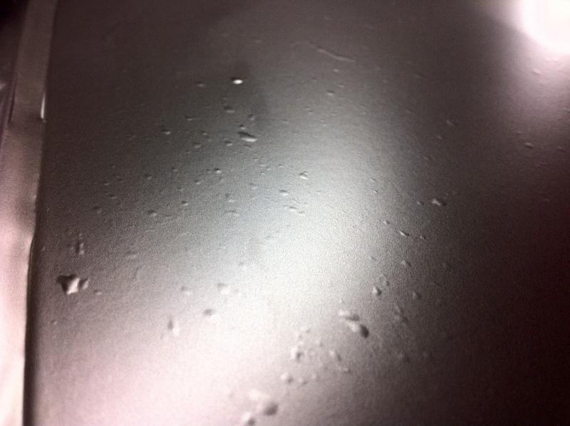

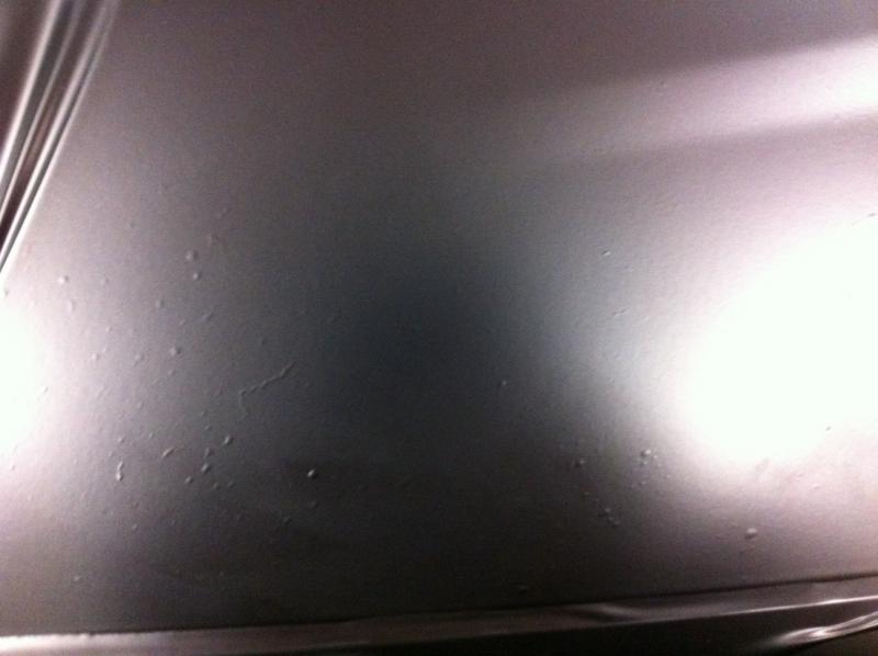

I just got a batch of Oracal 970M-070.
And when i try to apply it there is problem whit small bubbles. I rely wonder if its just me ore the vinyl ;)
I have tried both room temputure and much warmer. Still the same problem. So what i´m I doing wrong?
Pictures will follow shortly. This is the first time it has happend to me.

Here are the pictures.

Riskok
looks like not enough pressure
Hmmm I rely did put all the pressure I could on it even so hard that it got scratches and it still got bubbles.
either that or a bad squeegee ( with nicks and such ). those are my first two thoughts from the pics.
I always try to use a new and good one so the one I used was all new.
Looks to me like the vinyl is being allowed to pre-tack.

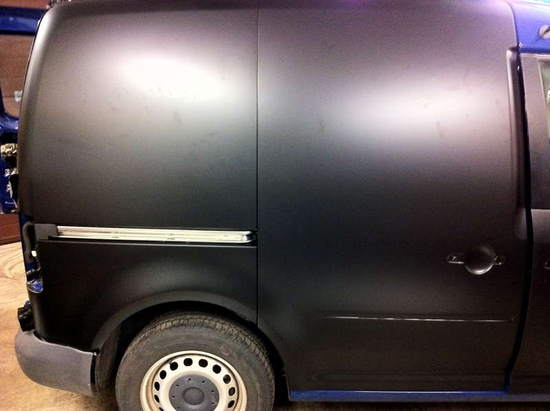

Looking good! Is the whole Caddy wrapped in flat black? Talked to my supplier today, ordered 15 sq metres of 975 carbon fiber and 10sq metres of 970RA flat black. Looking forward to trying them out :)
