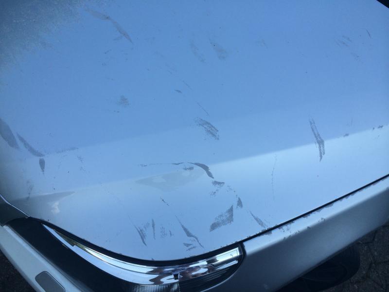

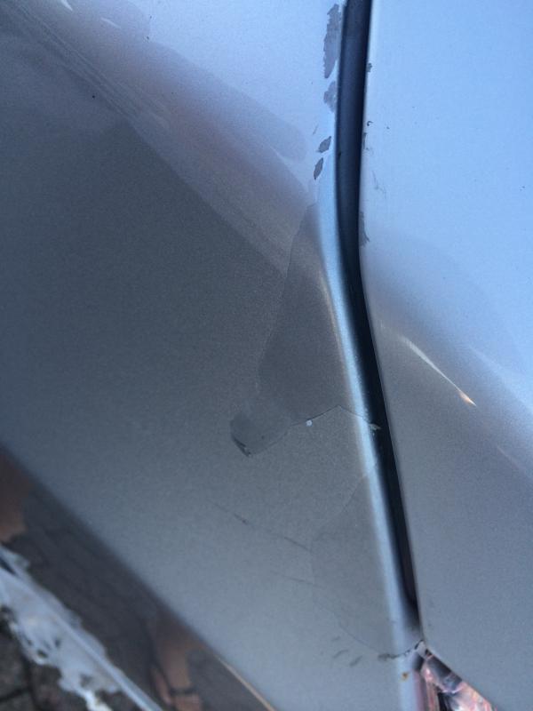

I got this from a customer of mine on a wrap we did 3 years ago.
It looks like the clear cote is coming of and I rely dont know what to say?
BR Patrik - Sweden

looks like customer abuse to me..the edges are getting chewed & someones peeled the clear...but you need more piccys
letterman7
Huh? Looks like the wrap was peeled off - the second photo looks like the adhesive left over. As for the paint chipping - that's new paint over old, not a clear coat. If it's been three years and your customer decided to try to remove it by himself, how is that your problem?
visual800
fist pic is the clear coming off but right above it , it what looks like primer under car paint so Im thinking customer F******** his car up by scraping stuff off now wants to blame others' like most of them do

It is hard to tell what is going on.
Did you remove the old wrap or did the customer?
If he removed it he does not have much room to complain.
The one photo does look like an area that had been repaired/repainted before the wrap and the new paint did not bond well.
How old is the vehicle?
Some lines of vehicles have a common paint failure after a few years (white Chevy express vans shed their roof and hood paint like clockwork).
Find out if this vehicle might be in a similar group.
Put up some more detail (& photos).
