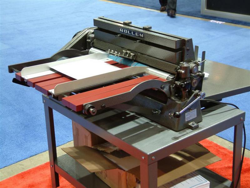

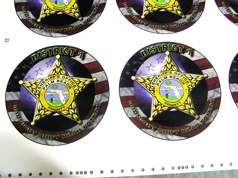

    A paper cutter such as THIS is what you need and to rethink what you want and need to deliver. Cut your decal repeats at normal scoring depth with about .25" to .5" gap between them; weed the excess off; apply transfer paper or leave naked; and finish with the paper cutter. That is the method used by 99.9% of the shops.
    These decals are printed with a bleed edge, plotter cut and then finished by trimming out between the gaps using a paper cutter. To insure we cut where we need to, we also use a thin line fluorescent light on the table top a few inches to the right of the blade. This provides a shadow for the blade edge through the liner.
    If you really feel you want to gear up for what is called slitting and semi-slitting, you would then want to be looking at a machine such as THIS. It will allow you to make through cut or partial slits of either the vinyl or the liner.
