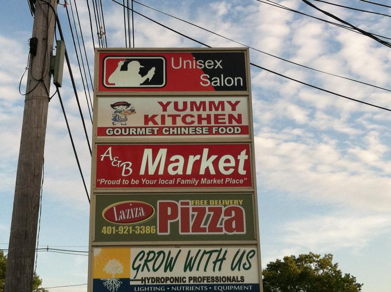

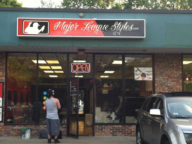

Overwrite 2 one second wait. You will waste more ink.
Works ok.
The white in the picture is the plexi showing through the clear.
Let it dry out or the 3651 gets real flimsy with the double strike. The lam will help that after.

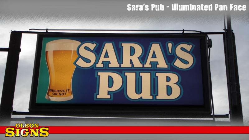

This sign is 3 years old.
No Lam, printed on 3651 Clear and applied to white pan face. Still looks as good as it did the day it left. (I'm sure its faded a little but you wouldn't notice it unless you compared it to one fresh off the printer)

Thanks for the replies. I have already done one and it looks good. This sign has alot of black fill and looks great under normal daylight conditions. In the dark with light behind it looks kind of gray. Is it normal for the black to turn lighter at night? Would the translucent vinyl hold better blacks? Not too concerned about this customer given the time restraints & cheap part just thinking about future work.
