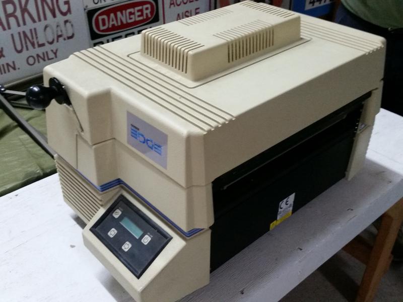

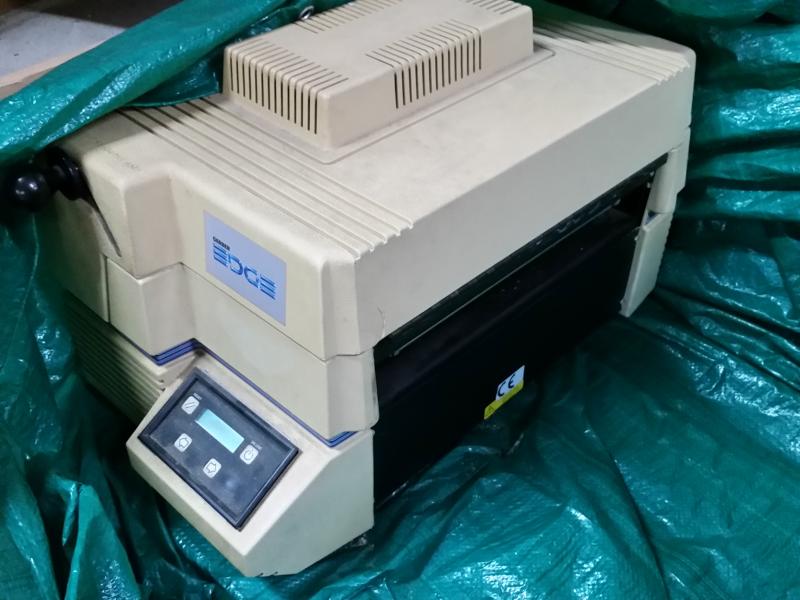

I have come across a friend who owns a craft and flea market with a number of vendors working the booth. One of the vendors, a sign maker, recently got dismissed from the flea market for not making timely payments for booth space. He took most items and belongings with him except 2 Gerber Edge printers and many ribbons. No software, no cables, etc...took all that with him. Is this worth taking home or is it a white elephant? Thoughts?

Been using my edge1 and edge2 for 20 plus years and they work very well only replaced one head on edge2 one time

The price of new software is pretty steep. And then you need a cutter. You generally need a Gerber cutter ( not cheap )
I think the picture shows the original Gerber edge.
However, Gerber had a deal ( and I'm not sure if they still have it ) that they would give you 5,000 towards a new FX Gerber,
This could be an opportunity for you to get into the market.
Anyone that has Gerber, will tell you they are tanks and just keep making you money.
Remember, "If you build it, they will come "

I told my friend, the flea market owner, the printer(s) are pretty much worthless without the software/drivers that runs the devices. He was rather discouraged. I don't think he left on good terms so he never returned to get the printers. He also still owes money so maybe that had something to do with it. Anyway, were still working when he left. I suspect he got out of the sign business after that.
Needed: Serial port cable, Gerber software, Gerber plotter, owner's manual....
I'm already in the sign business so that's why my friend called me.
Yes, they are free to me if I want them,,, trouble is, am I wasting my time with such old equipment? Will it be a challenge finding supplies?

Got the software already. It appears the driver is already in my Flexi Sign Pro software. Now, where to get a plotter?
SightLine
You can run it with FlexiSign Pro and if you have a cutter that has an automatic optical registration system you can cut with it just fine. What I mean on the cutter is one that Flexi supports to begin with, and has some sort of camera or mark detection system. When you use this sort of cutter in Flexi, you add a contour cut to whatever it is you want to print, Flexi then prints some specific type of marks (what the marks look like depends on the brand of cutter) around the print when it prints. Then you put that in the cutter and the cut job will be sitting in Production Manager, you send that and the cutter will then ask you to position the pointer or knife over the first mark. Then it detects all of the marks and cuts the job.
We have the second model Edge, the Edge LE which was the first front opening one before the Edge II (it is pretty much identical to an Edge II). We use it with FlexiSign Pro and cut the jobs on our Summa S160T and it works great. So really all you need is a serial cable, a preferably REAL (many do successfully use emulated USB serial adapters) serial port on the computer that has Production Manager, and the right type of cutter.
You do not have to have Gerber Omega nor a Gerber cutter to use it.... We don't have either one, and never have.
