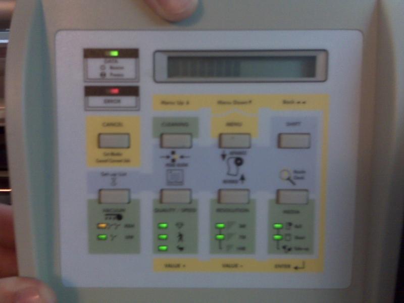

I have a falcon outdoor jr that is locked up somehow, I turn on the power and the interface panel has all the lights lit up and the display is half of a progress bar, the bottom display shows the heaters doing their startup check but other than that the printer does nothing. Any ideas.

I have tried to boot into diagnostics but the panel does nothing and just stays with all lights on, not button works.

every light in the panel is on, this thing is completly locked up, where do i check to see if the main board had an overflow onto it? This unit belongs to a friend of mine who is in the sign business and i'm trying to help her get it going if possible. She said it started giving an error code at one point but she ignored it and unplugged and replugged the power to clear the error, then it worked. She never did write down which error it was giving. Now the whole thing is a large piece of plastic that takes up space and cost around 15K.
