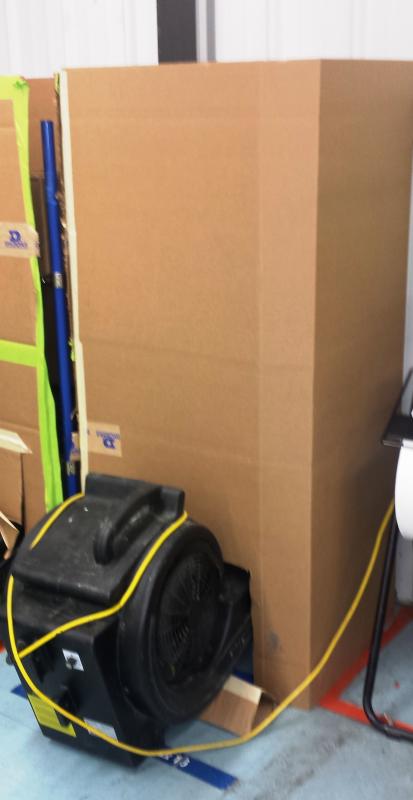

Interesting! I did not know that solvents outgas downward. I have attached a picture of what our drying chambers look like. We have two huge floor fans blowing up from the bottom. That may not be the best solution if they are outgassing downward, not upward. We are looking at getting a box fan replacment today, thank you!
That is ours in the thread linked above. The box fan is on low speed as the solvents don't out-gas at a high rate of speed and it keeps the multiple rolls inside from fluttering around and touching each other.
That is an awesome design! Way more high-tech than ours. I am going to talk to one of our engineering students to see if he can build something similar. Thank you so much for your help!
