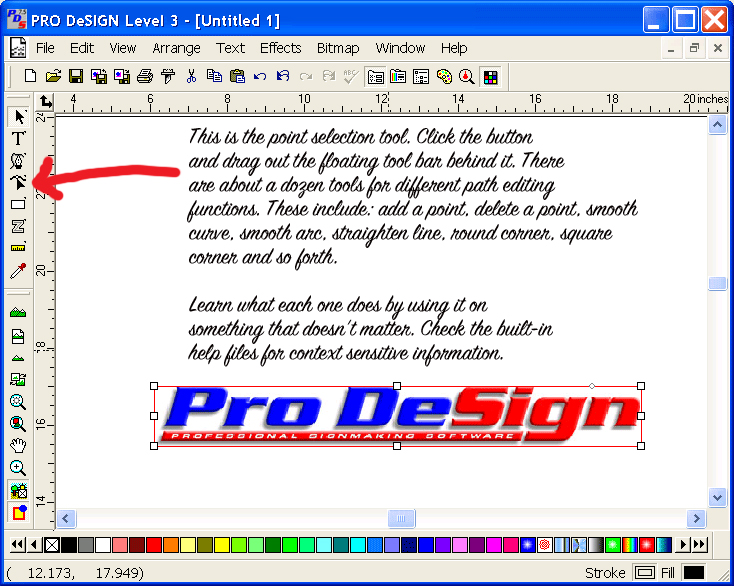

On the left side of your screen there is a vertical bar with several tools in it. Hover your mouse over each tool and a little box will appear and tell you what it is. You are looking for point selector tool. On my version it is second from bottom. If you click and hold on it, and drag to the right, a tool box will "fly out" with many more tool options. Pull up a vector graphic and practice with the tools to see what they all do.Make sure you're playing with a vector graphic, it doesn't work on bitmaps. Also fonts will need to be converted to curves to be able to manipulate points. If you have the manual, read it and learn what you can from it, but playing with the tools on a graphic is the best way to learn in my opinion.
Fred Weiss
the point selector tool
