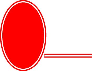

Ok here is my scenario.
I have an oval with a line next to it. (See Pic below) after looking at it I would prefer the end of line to take on the shape of the oval but cant fiigure it out in Flexi Anyone?

captainron19
I dont see any trim command in Flexi - What I am trying to do is this. I still want the oval and end of line to be seperated (Do not want them joined) Alll I want is the end of the line to take on the outer shape of the oval

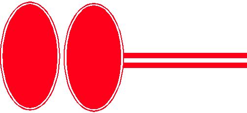

Captain Ron,
Just hold down the control button, select the oval, move it away to a free area, release it and you have a copy of the original. Then a fix it to the line in what ever way you desire and at what ever size.

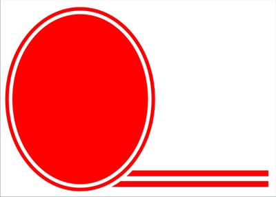

So you want something that looks like this (see below)...
The trim command is from corel (sorry) in the old version of flexi I have the command is called "cut out" and is under "Tools" > "Combine". Will be with "Weld" and other similar tools.
Select the lines and then the outline of the oval. On my version of flexi, it depends on what you select first that will be "cut out". Then do the cut out command.
Oh, and stretch the lines out over top the oval before "cut out".
