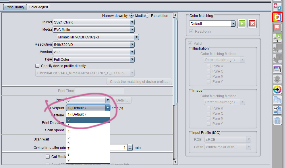

After a lot of tests, I've found some options to keep working with missing lines. Quality mode and unidirectional is good idea, but it didn't get a good result with my issue. So, now I'll tell you what's worked for me with a whole line missing:
Basically you have 2 options: overprint or increase ink limit and density

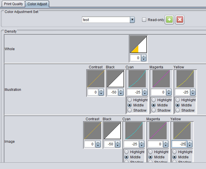

a) Overprint: choose overprint 2 and reduce ink density of the colors that are working fine (see photos 1 and 2)
My example: one whole magenta line missing, then I choose overprint 2 and reduced ink density of Cyan, Yellow and Black.
Pros: print result is almost perfect
Cons: overprint is when the machine does the same pass 2 or more times (in this case, drops ink twice in each pass), so, printing is slower

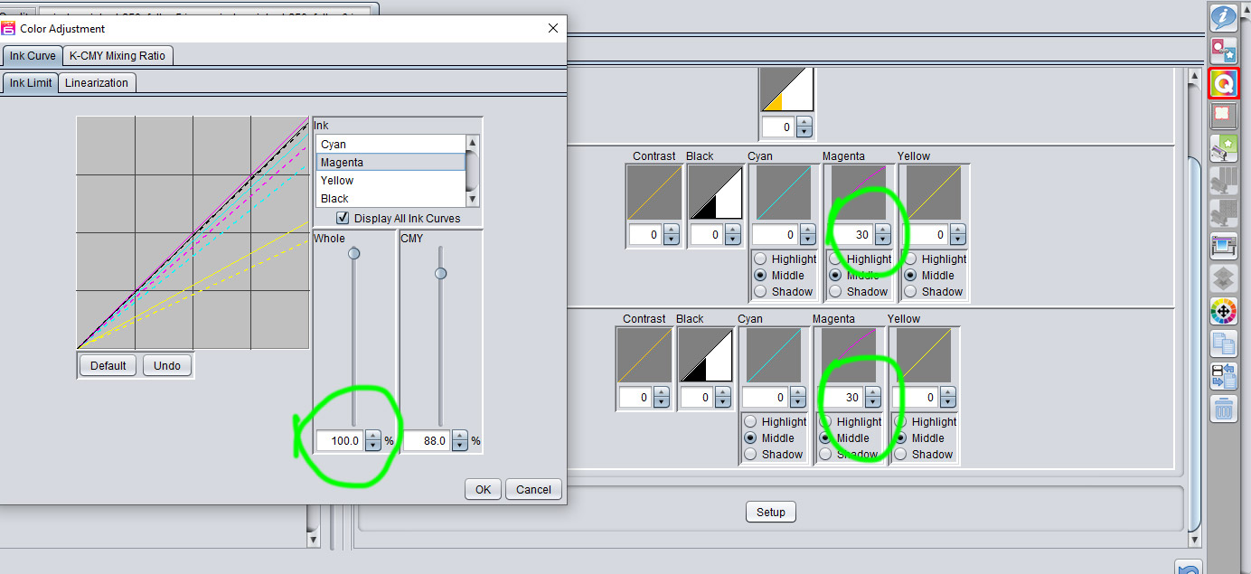

b) Ink density: in this case, you keep using the same profiles you were used to, but increase ink density of the color with missing lines; If increasing density is not enough, also increase ink limits (Advanced color adjustment -> Setup > Select the color with missing line and increase ink limit in the "Whole" column. (see photo 3)
