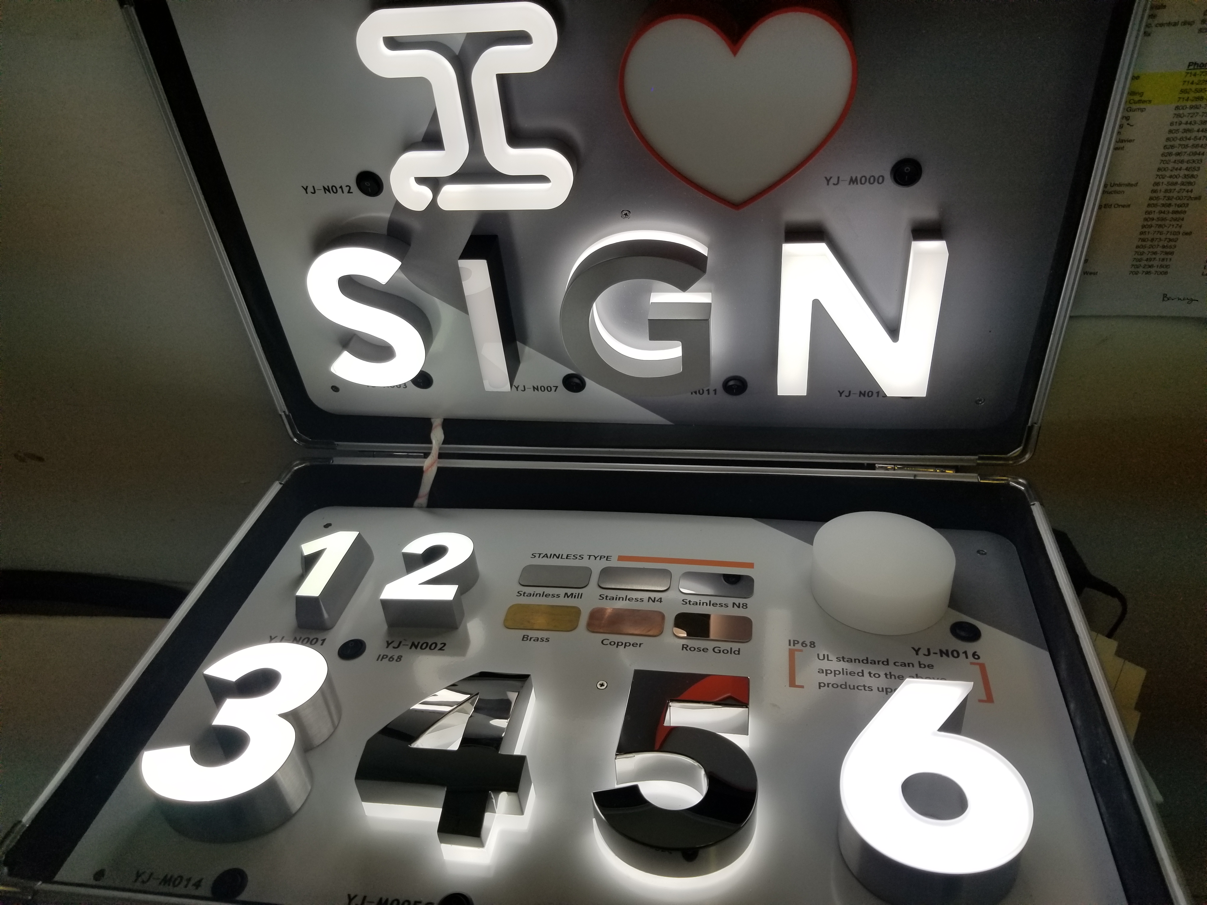

    Is this what you had in mind, they are doing these types of letters in malls. These are from AA leds in CA. They are from China so cost is reasonable and short lead time. The #2 is 2.5" Tall. 20190514_134546.jpg
    • OMG / Wow! OMG / Wow! x 1
