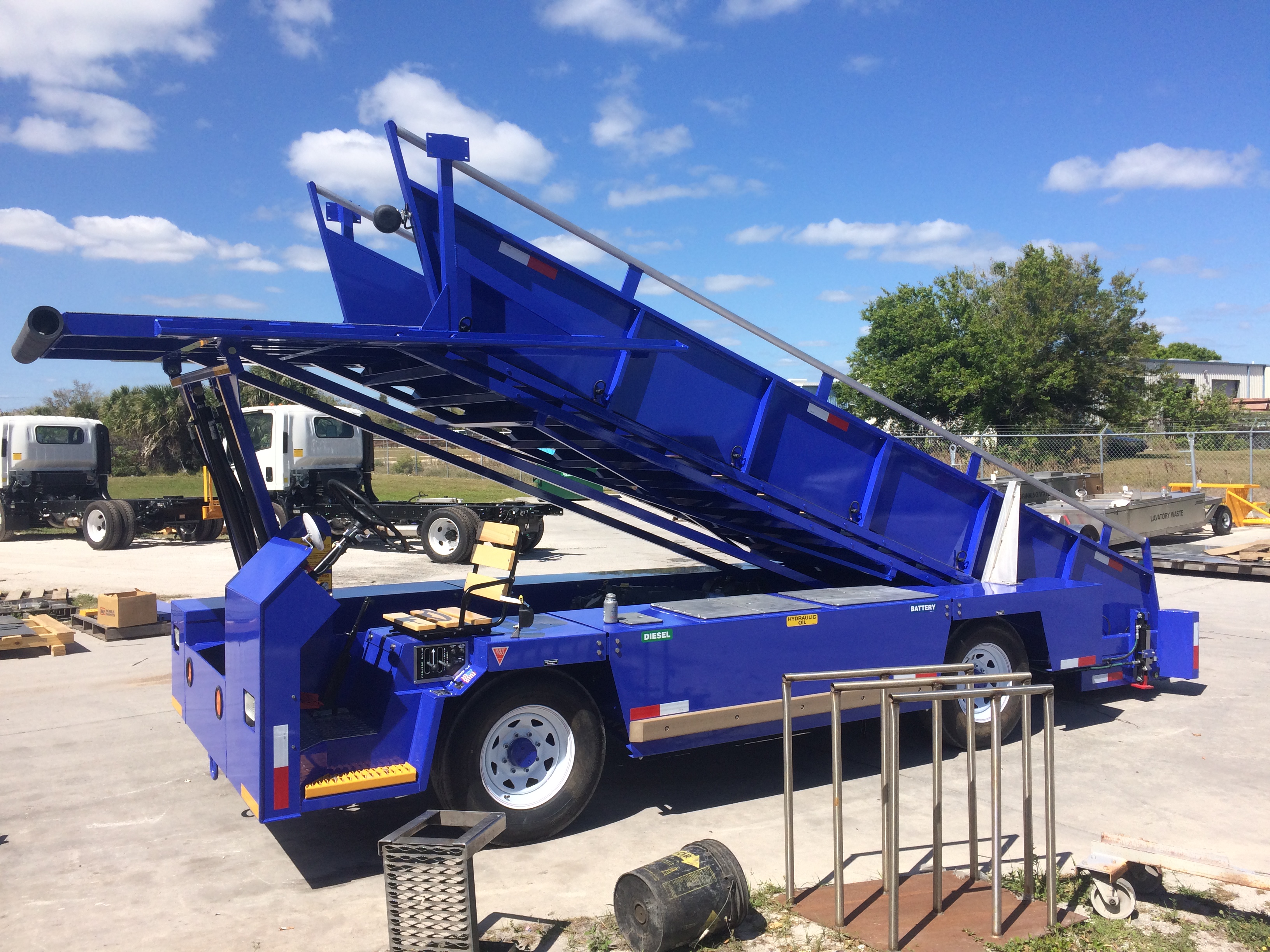

The stair truck is sanded and epoxy

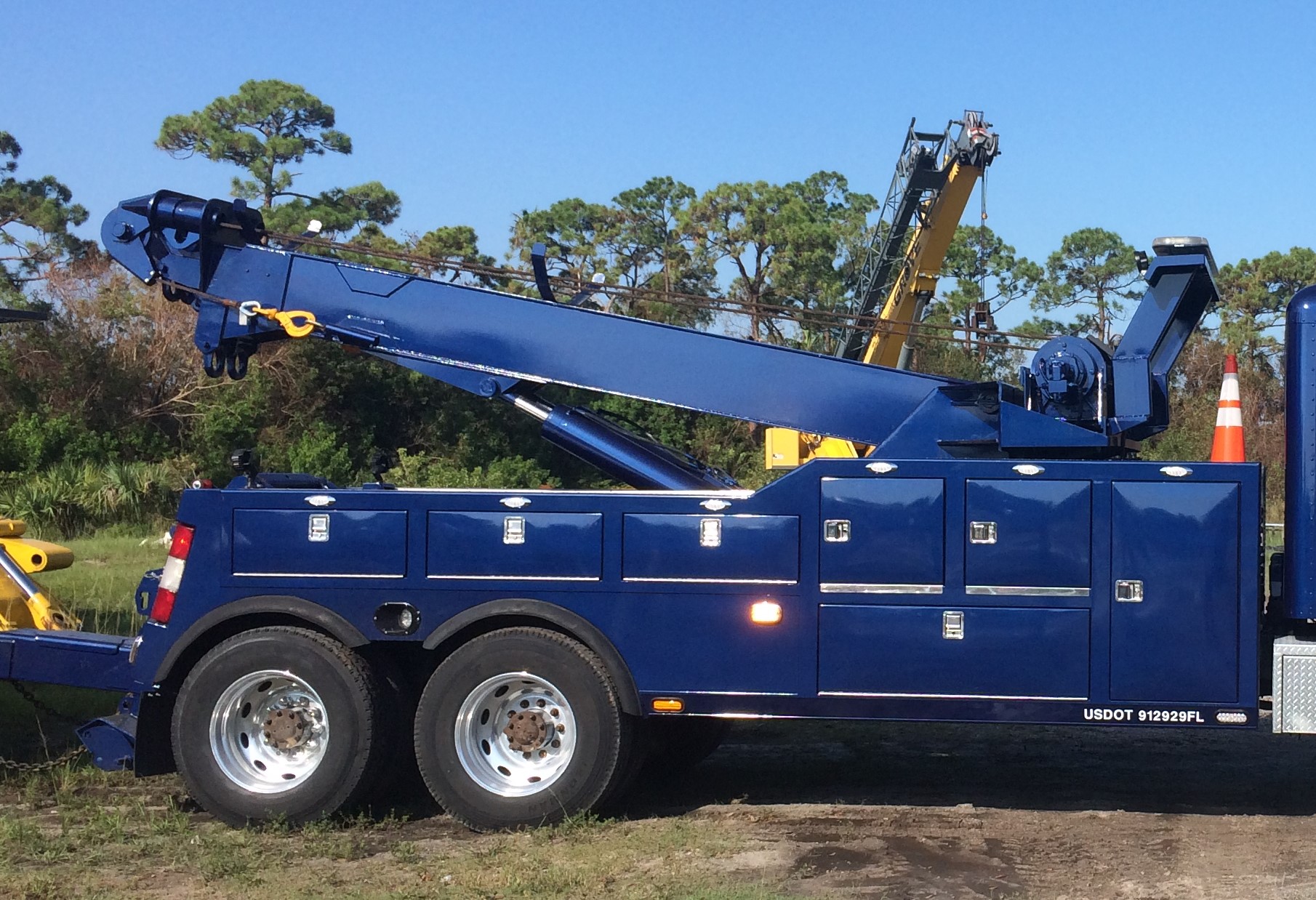

Tow truck was sandblasted and epoxy

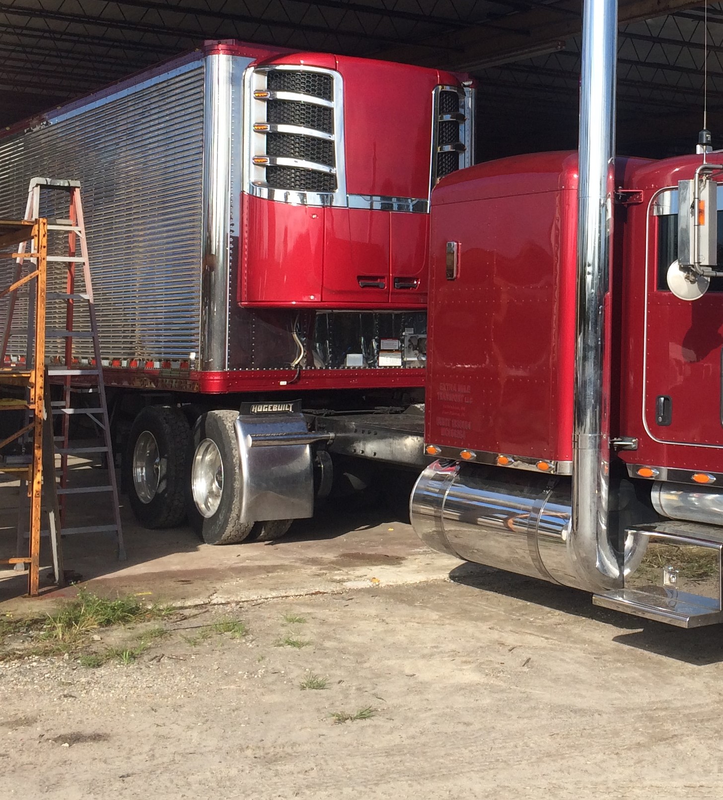

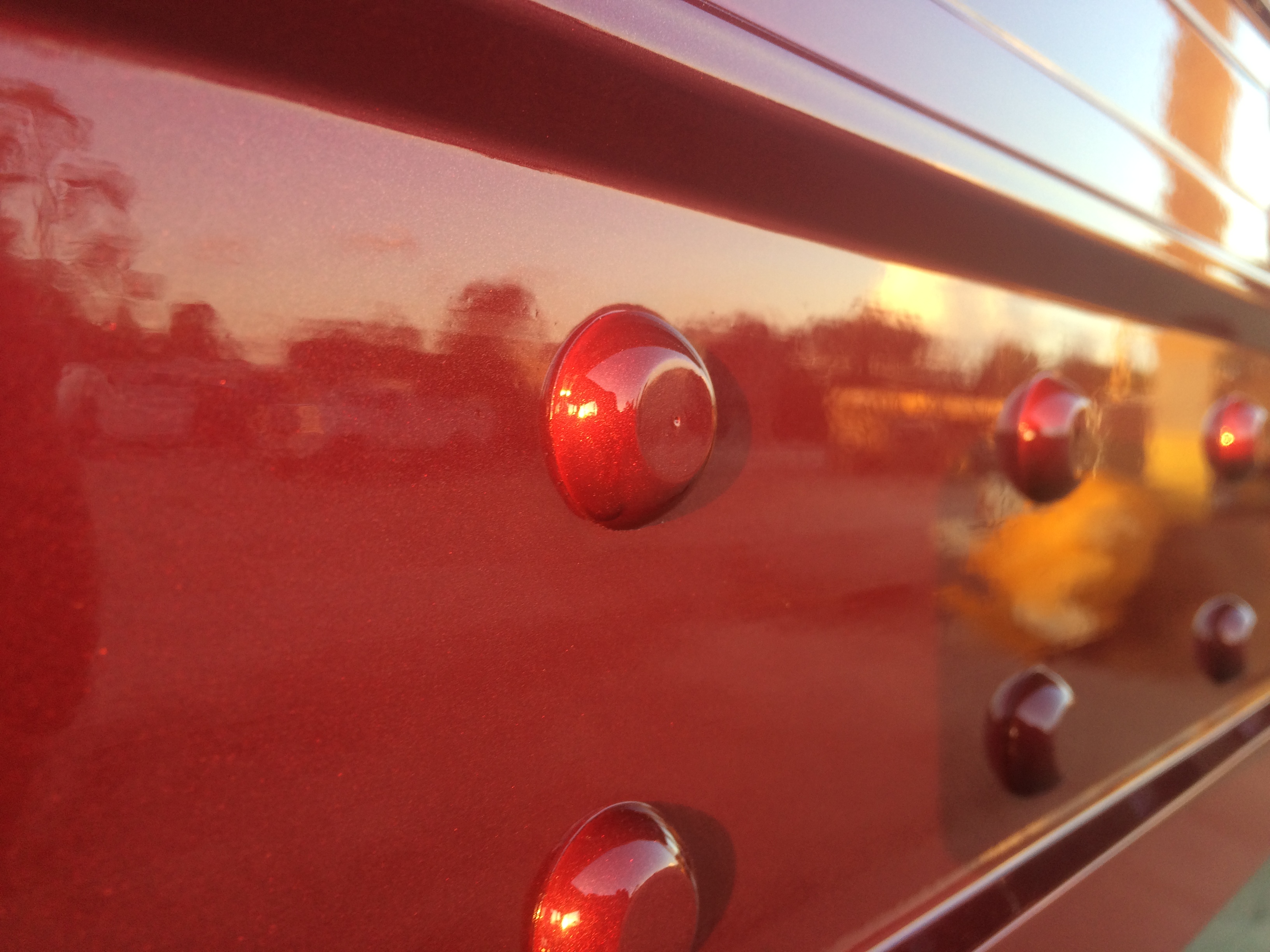

Reefer trailer was etched with vinegar, self etch primer, epoxy
all have 2k polyurethane single stage top coats
