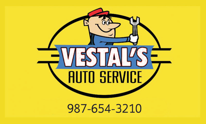

So... i got the gig with the print inside the pan face which i've never done... but you that know me.. i'm trying to grow bigger and better. And i have another 5x8 pan face i just placed an order for.. but it's just trans. vinyl.. But I would just really appreciate some feedback on this layout i'm working with.. any suggestions will be greatly appreciated. Am i going in the right direction with the wrench man? The customer likes the little guy....

I bet they insist on the phone number, eh? It would be great if you could leave it off. Other than that, I like it!
You're going to spray paint the inside, right?
Dan Antonelli
watch your contrast on main copy... red on blue is not going to read well at from distance, and you should never outline red with black or vice versa. You'd probably do better pulling the character out, flush left and main copy to the right so you can get some bigger letters on there and make better use of the available space---
do the squint test on the thumbnail - phone number is most prominent and legible thing right now (which you shouldn't have on this type of sign to begin with, but if they insist, you can't argue)

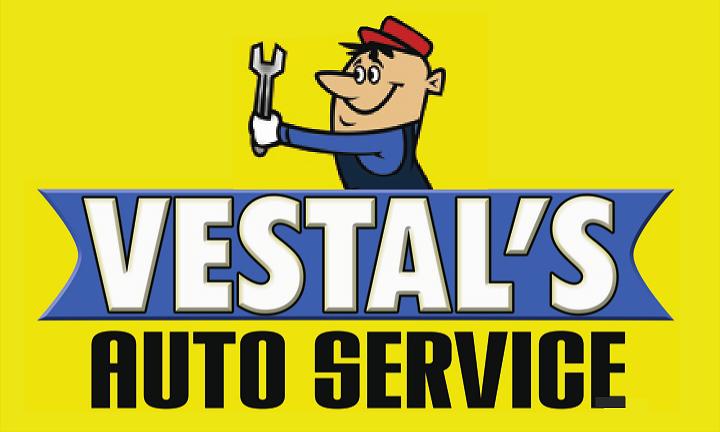

How about trying something along these lines?
Thanks,
Kurt

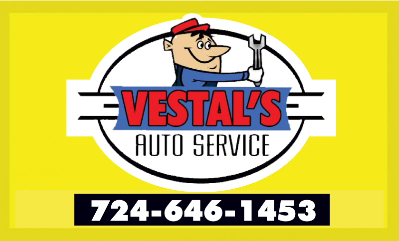

Thanks everyone! I appreciate the feedback and was wondering how about if i go toward this way??? The yellow looks weird on here cause i did it in CMYK
Jillbeans
Auto Service needs to be more important than the phone number.
I like when all the digits are the same size.
Thinner font on number thicker on auto service.
Try the name in just white with no yellow fade.

sorry! takes me a few minutes to save it cause of the size. Any better?? (color is still weird)

I really liked the first one. I would raise the little guy up so his overalls didn't blend into the panel. It would also raise his hat/hairline above the black outline that passes under it. Shame about the phone number.

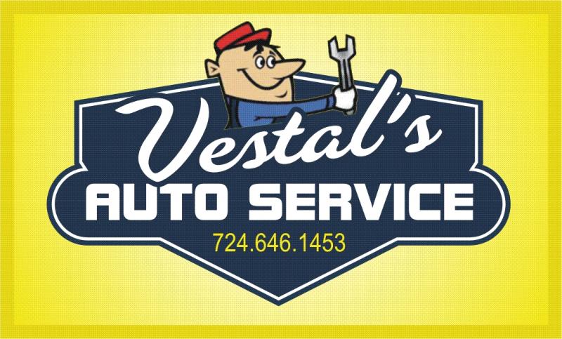

I've only done one pan face and that was for myself here at the shop and i really need this one to be "the attention grabber" to gather more jobs like these.
I really like the first one also and since it's going to be a print, I thought i could sell business cards on it also! I told him i would have something to show for tomorrow... so maybe i'll play with the first again also since i didn't save over it i hope!
slappy
now what to do with the phone number..:banghead:
opps! pointing the wrench wrong way also!

Love what Signcrafters did with it.
Adrian has a great suggestion about eliminating that bottom element too.

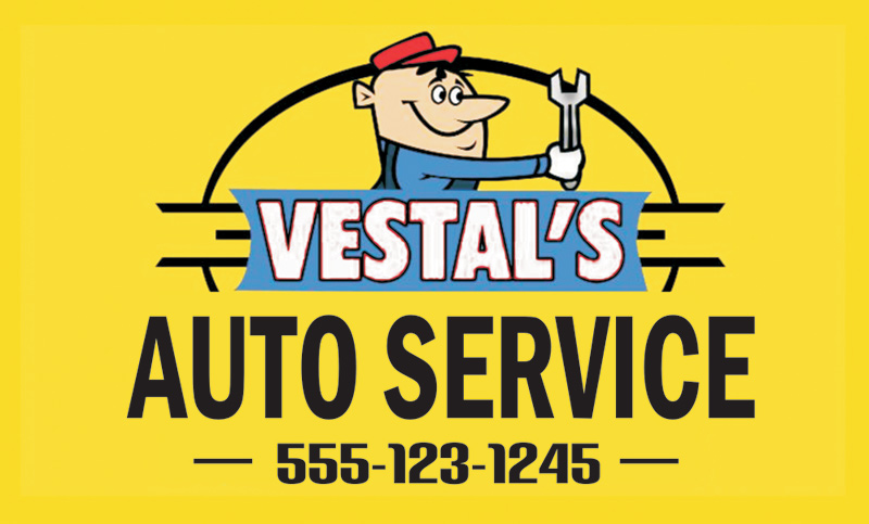

I like the first layout as well with these exceptions.. imo. VESTAL'S seems to small and is fighting with auto service for visual priority. I don't feel there is enough contrast between the red copy and blue panel. I like the overall layout though without the phone.
