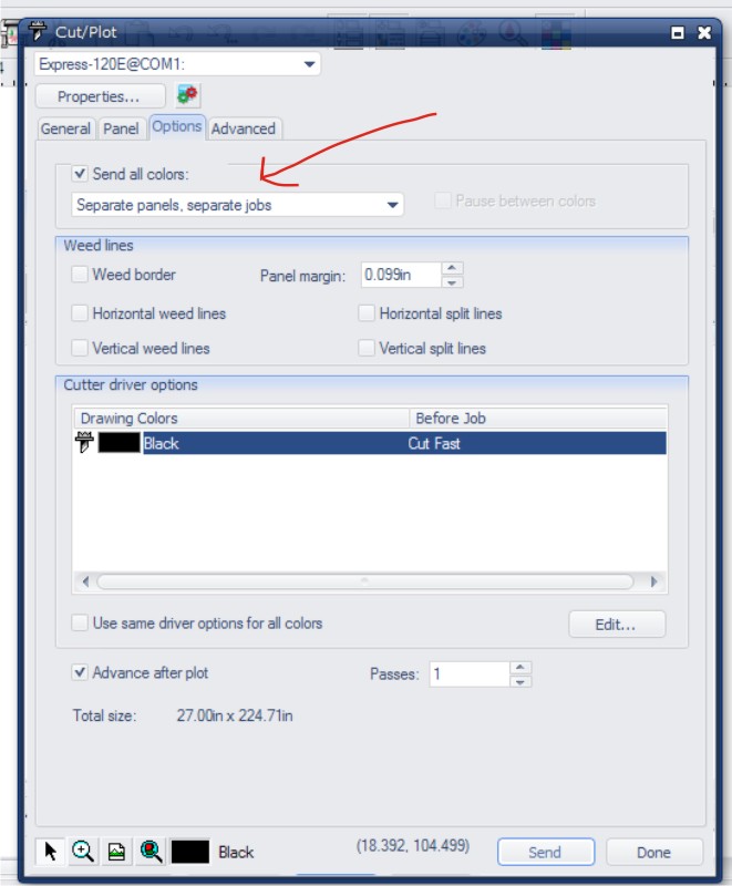

i have a 10' graphic that I need to run
that's paneled.........where in Manager, as in Omega Composer,
can I specify that I only want to run panel #1 and then pause???
Is this it???
Marlene
From composer go to file, output all. on plot page go to layout tab, panels. there's a box that you can check off to pause after each panel
GARY CULY
i seen what she said on my flexi8 but the screen you showed in post doesnt look like my program does ..even though ,the place she said is correct to fix question id bet..does same thing ,different look to screens
Mike Paul
Super Active Member
In P. Mgr. click on "panel" and then simply right click on the panels you don't want to print. A grid will appear over them meaning they won't print or cut.
Click again to activate the panels you want to print or cut.
