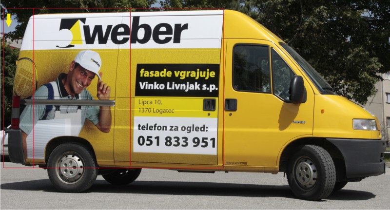

This week we did this van. One side was done with 3 panels...
And, i have two questions..
1.
First, we start at the top, on whole width of panel. Then we proceed down, to the bottom. When we were doing second pannel, we have to match 1. and 2. pannel, at the top everything was ok, but at the bottom there were 1-1,5cm difference. And even in the middle there was some diference. Like it was extended. But we didnt pull it that hard, that there should be any extention...
How do you seam panels, that it matches on whole height?
2.
implied windows. So, wans often has implied windows on side. how do you wrap vinyl into these corners? We heat vinyl up (dont know how much degress, becouse i didn have laser with me), and wrap it in, but after a few minutes somewhere vinyl pop-out.
When we were at wrap training course, guy told us, to heat it up to 90 C degress... But i forgot, when. Before i wrap it in, or later, when it is in its position??
So, any suggsetion on that problem??
Thanks for replys!

On something like that when doing certical panels, I always do a hinge in the middle and start there essentialy breaking it into 2 parts. I find this way the stretching is less as your are pulling on less material and it's easier to work with. Makes it much easier to tile as well I think as you tend to get a more even stretch on each panel.

I always use a hinge at about 1/4, lay the top and work the rest down, do it for every panel, very rarely encounter that issue. I have in the past when laying down from the very top down.

So, for now, there is only one big problem, that i dont manage to solve... Implied windows... This weekend, we did another car, and still have problems with these implied windows. The corner is too big, or what... i dont know... During install, we went over them, and we band it in later. Ofcourse we used heat-gun. But on some places vinyl pop-out for about 3cm! if we band it in again, it stays there for few minutes, and than again...
When i watch some others van, i see, that a lot of them has cut-out this corners. But i think, that this is not ok, and it also doesnt look very nice. But i also saw some vans, that has complete wrap, and vinyl in these corners is nicly band in these implied windows!
