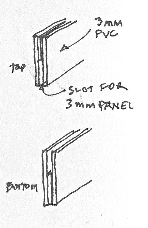

  9. Johnny Best
    Johnny Best Very Active Member
    3,423
    1,915
    113
    Dec 9, 2015
    buffalo ny
    I use scraps of pvc. Just get yourself some pvc glue and doublestick tape to attach to your panel. Use 3mm pvc for your changeable slide in copy panel.
