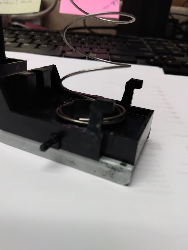

I am on the hunt for a particular part for our unit and for a manual to help me tear this thing apart. I have been unable to find anyone in my area to help me service this machine. This is the piece I am looking for.

That part only comes from Mutoh as an assembly with a bunch of other parts for $595. I can tell you though that, unless there is physical damage, that part shouldn't go bad really. You might just need a new cap top. What's the issue with the machine?
ReginaK
I broke the part that holds the cap top on, trying to get the cap top off. We have tried gluing it and nothing wants to hold. This machine hates me. I have been having color issues with it now, I loose magenta and yellow. I replaced the cap top once and it did not work. I was working with our ink agent and he had me take the cap top off to check the lines and that is when it broke.
Solventinkjet
DIY Printer Fixing Guide
Gotcha. I would look around to see if anyone is selling used parts for that machine on Ebay. Otherwise, the only way I know how to get that part is the $595 route unfortunately.
