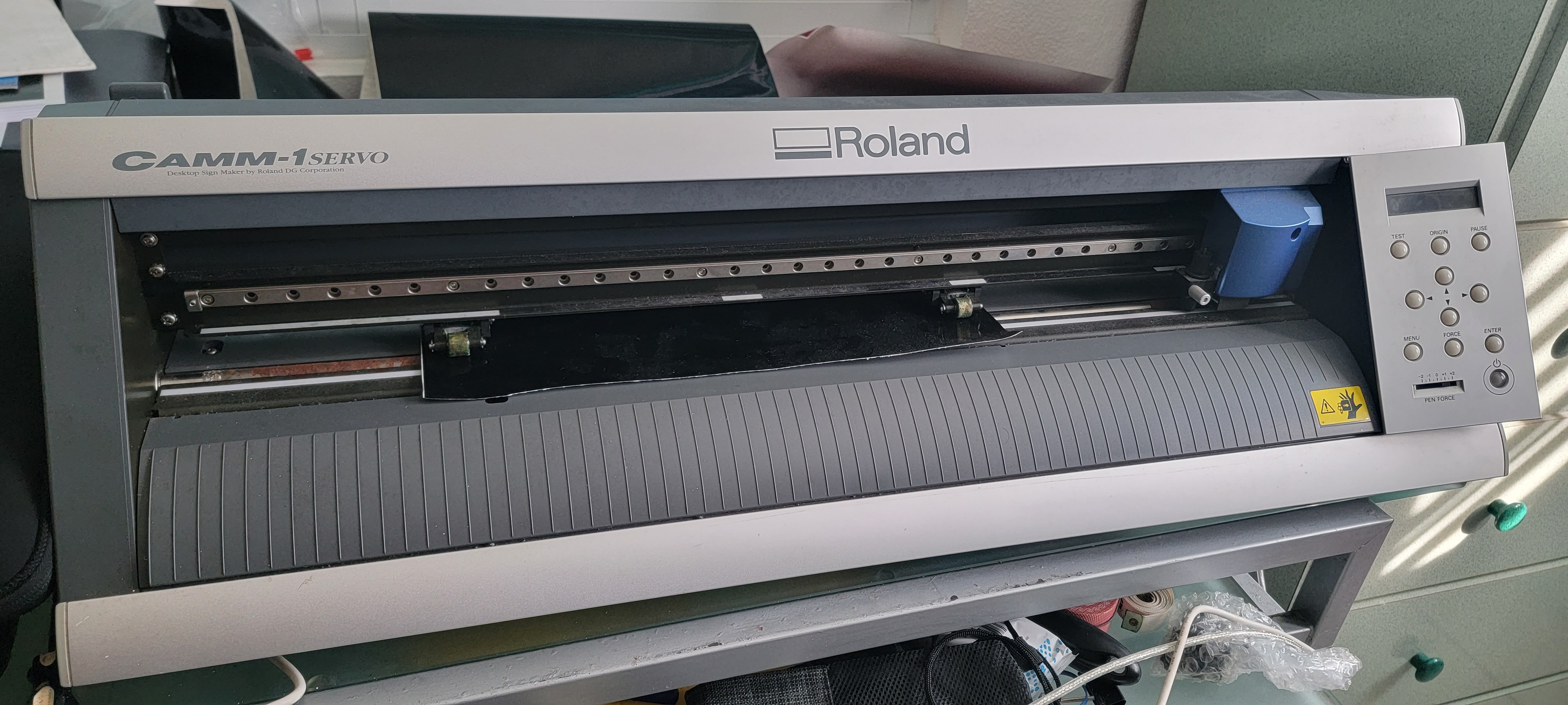

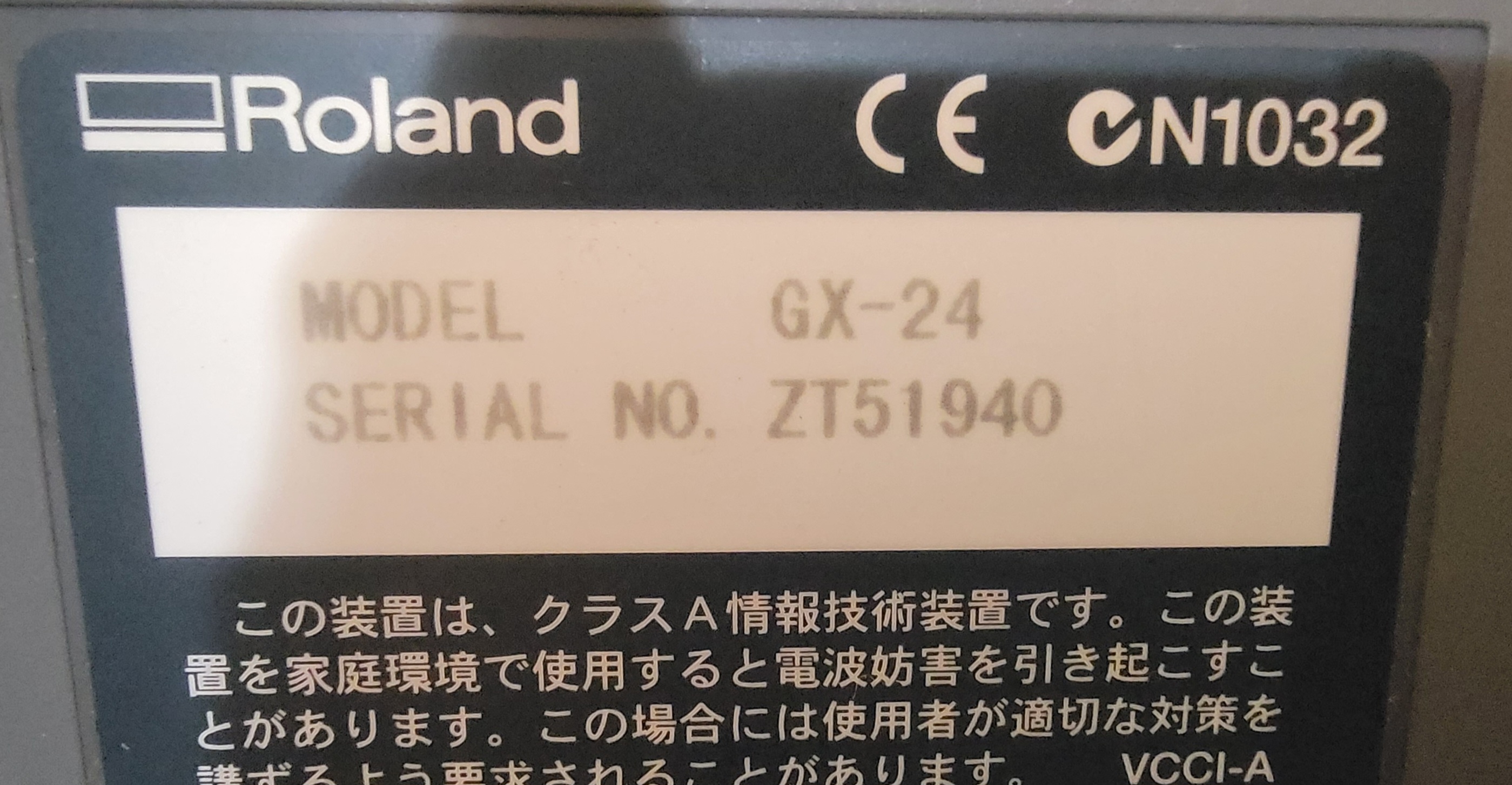

is it ACTUALLY a GX-24?
according to roland, it would only have a usb interface.
there would be no serial or parallel port on the back to plug into
please recheck model & serial # & if you don't mind post a picture
JackiePR
I'm sorry about the accident.
The picture was the best I could take. It is a GX-24 CAMM-1 SERVO serial # ZT51940 with USB and female Serial port on the right side.

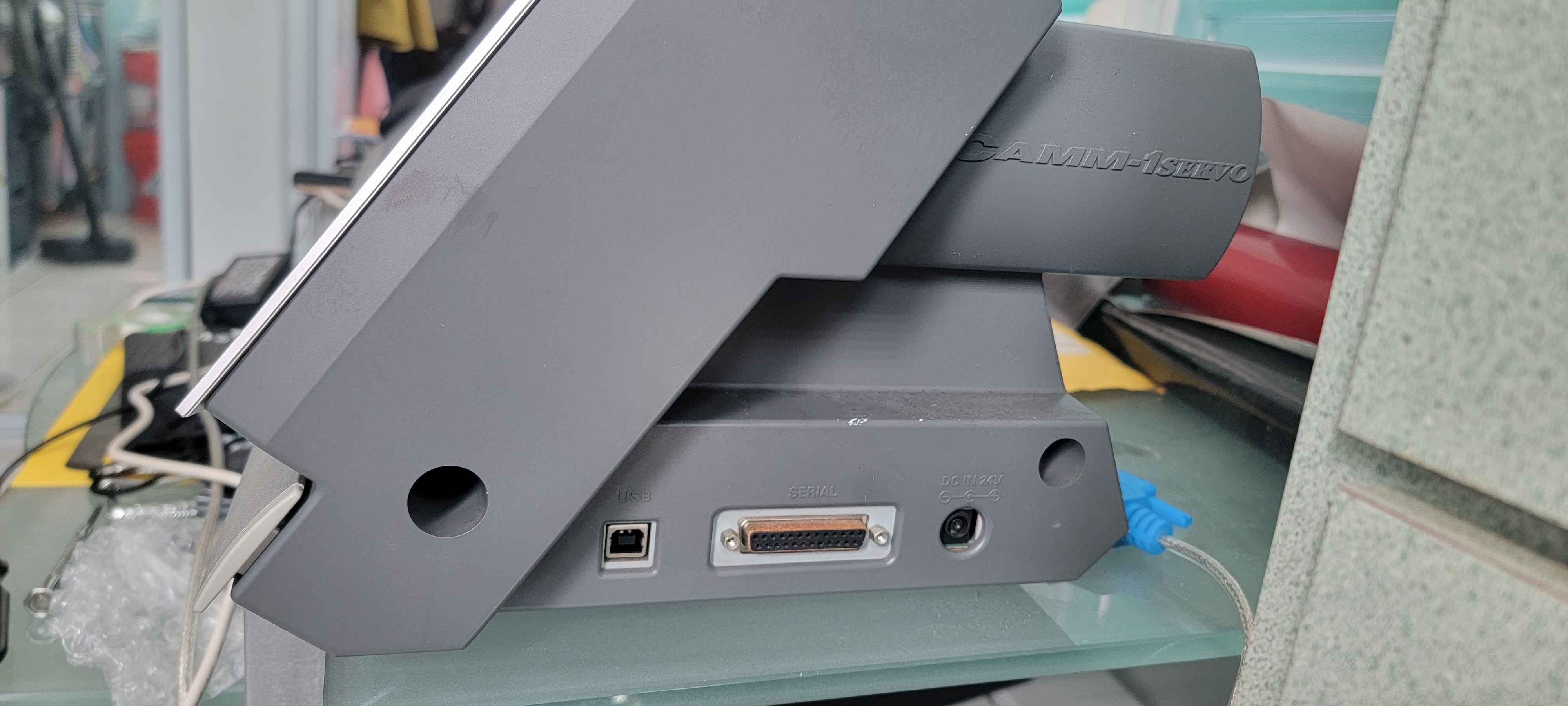

Can you post a picture of the connectors on back of the machine?
I looked at spec sheet and it said your machine is usb only
prhps I download the wrong thing?
JackiePR

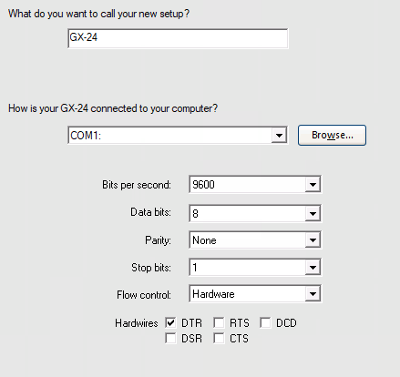

Hi, I ordered a male-female Null modem dongle and connected it. I got it to start cutting the word "LABORATORIO " but when it got to the last 4 letters "ORIO" it went crazy cutting across the letters it had already cut.
I was so happy until that happened....
Well it almost worked‍♂️.
Attila Nagy
That could be memory overflow. Most Roland cutters does not have all handshaking pins connected. still try set the same flow control setting on the cutter and your software. If your software supports full control over the serial port. Try disable RTS and CTS leave DTR only for flow control
