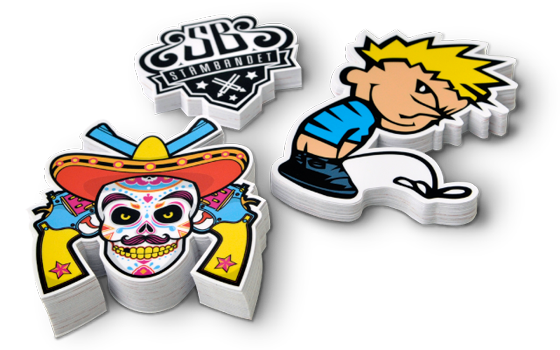

I'm printing with a Roland SC540 (print and cut) and using flexi-sign. Can I do a perf cut/pop out stickers? Can I make something like the picture? if so how? If not, what do I need to do this? any help will definitely be appreciated.
picture does not belong to me obviously. just an example
You can do it in Versaworks. Make another cut line like you do with cut contour, just select a 100% color and label it PerfCutContour. Be sure to select spot color when renaming.
Edit: I don't have a 540, not sure if that makes a difference.
