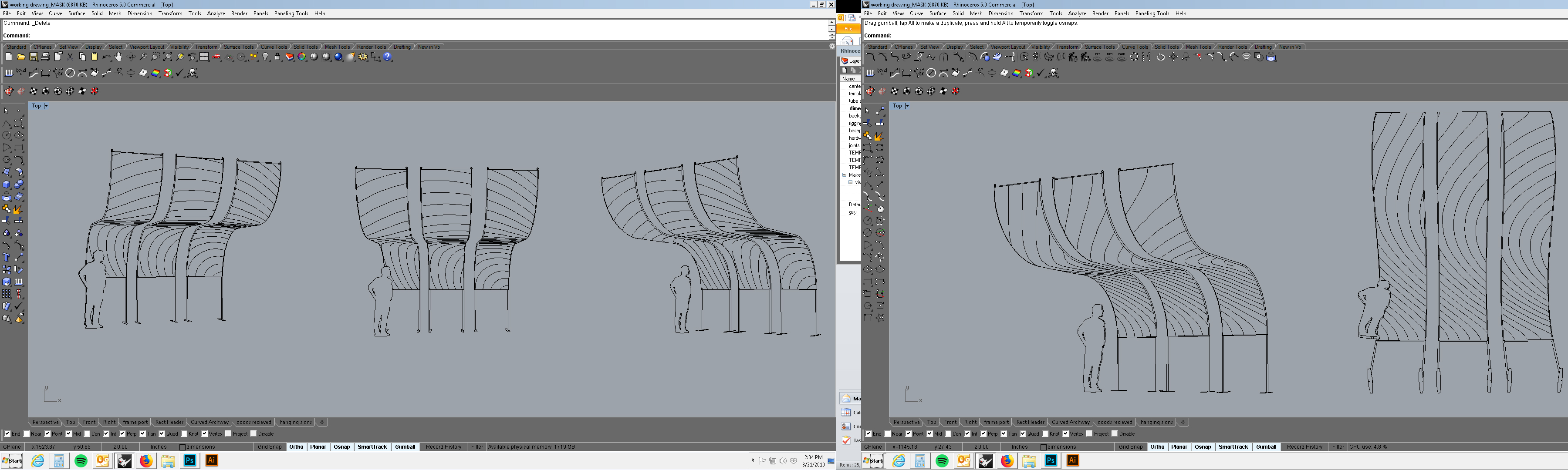

The issue IS perspective. Here I flowed concentric circles on the flattened surfaces on the left. The right I projected the circles onto the surfaces...(from only one vantage point)
IMO, modeling the problem is going to solve real world problems BEFORE you start cutting stuff up.
You can account for perspective by setting up viewing distances, angle of view, and height of "viewpoint"
It will give you a rough idea, which is better than the spaghetti test.
Rhino has a tool to "unwrap" the curves from your model surface...and can go right to Illustrator with vector artwork.
Cad is the tool!

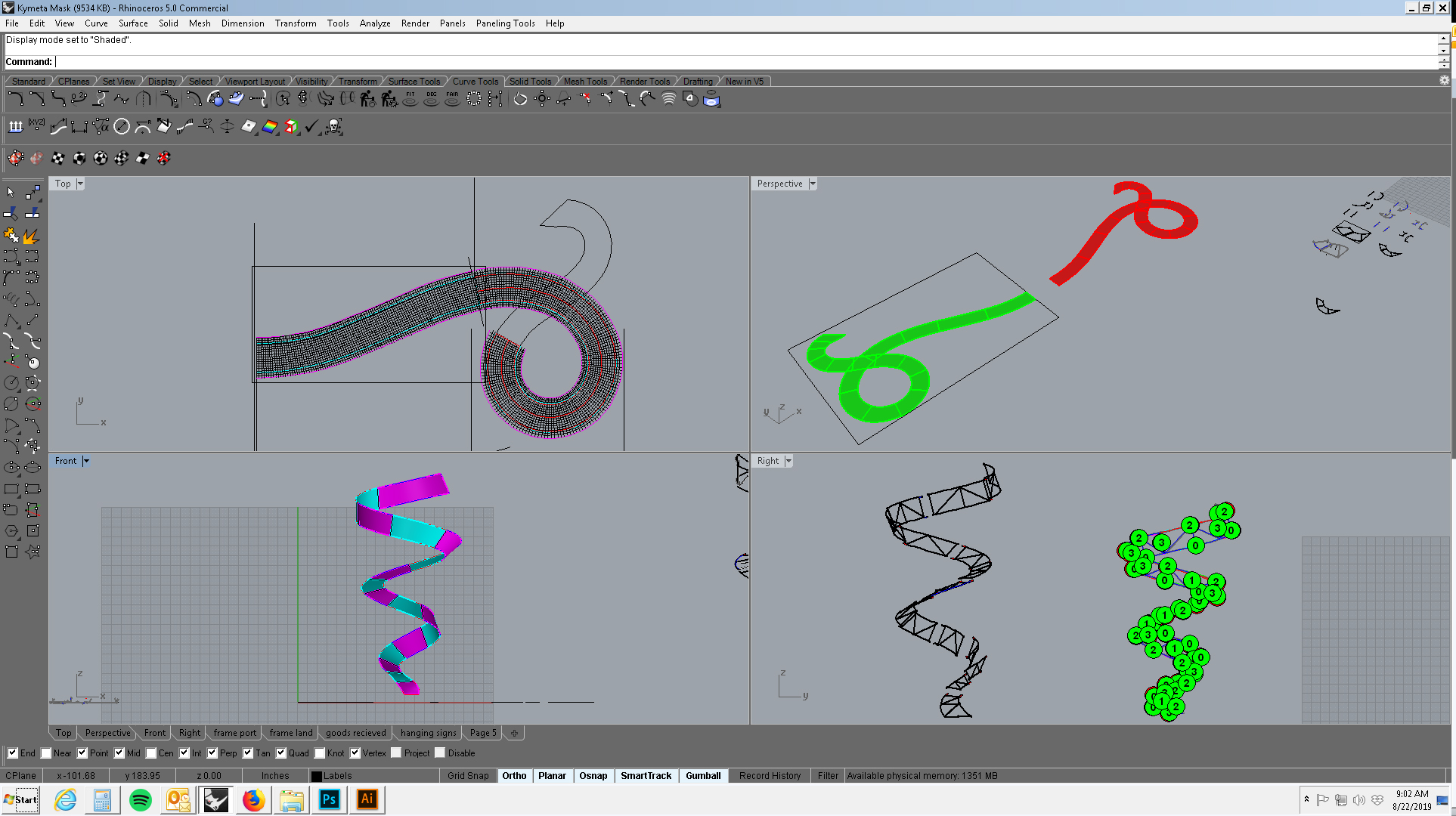

Check THIS one out!
The flattened dielines self intersect because the whole helix structure has a twist too!
My brain hurt for a few days after this!

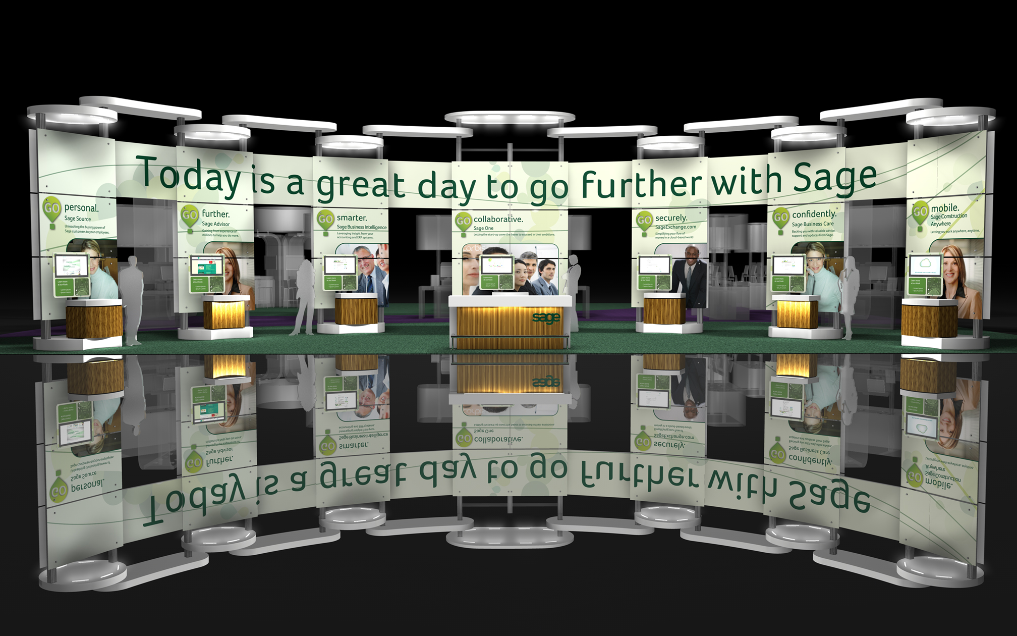

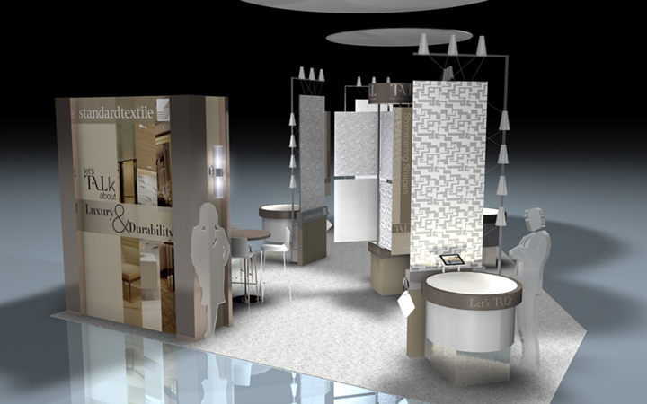

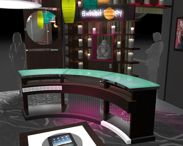

We get a bunch of unqualified applicants for sure! I have been printing for 20 years, been a printer tech, blueprinter, cabinet maker, exhibit design conceptual artist, detailer, residential engineering tech...
Could not do my job without foundational knowledge I've learned form all of these disciplines. I was lucky to get in to printing BEFORE digital took over. I noticed drafters and "graphics" people were always butting heads...so I taught myself both! Here's some renders I did at my previous workplace...
I think 3d printing is the next biggest deal! Some really cool stuff going on with parametric design/robotics. I have toyed with grasshopper for rhino a little...just google search some of the stuff people are turning out!
