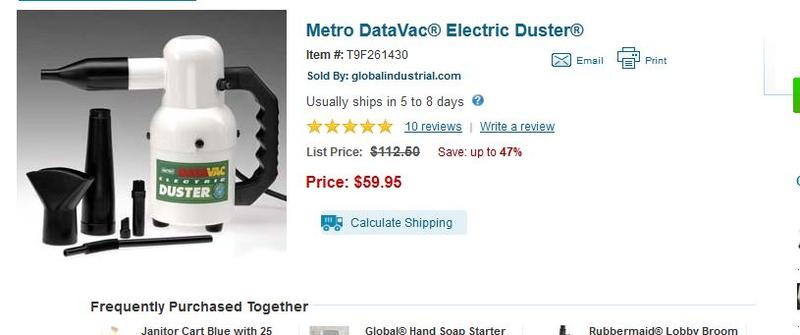

We use one of these. Works like a charm.
