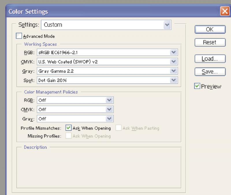

This is the way my settings look in PhotoShop 7.0. (I know it very old)
Should they be set differently?
I print on a Roland SP-540v using Versaworks RIP.
Appreciate any and all comments.

threeputt
Techman, I've read through the entire comments by Brian. But I'm still very confused. Since he's setting up artwork for sheet-fed print production, would those settings be useful for me and my application?
What I'd ideally like is for someone who's running similar software and hardware to help with the exact settings.
visualeyez
Threeputt: First change your RGB working space to Adobe 1998. You also want to change your Color Management Policies all to "Convert to working...". This will convert any rgb document you open into Adobe 1998, which is the ideal profile for CMYK printing. I would also reccomend converting any CMYK files you recieve into Adobe 1998 RGB before printing.
