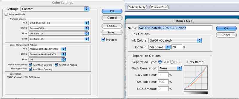

    Erin: The trick is to understand your color working space and the relation to your peripherals. First get a book on color management!
    The easiest tip I can give you now is to make sure all your files are tagged with a color profile coming into Photoshop. If your file is tagged your printer will ditch its own profile and use the interpolated LAB color equivalent to get the color to match with in the ball park.
    The most generic is sRGB, this profile will work with 90% of desk jet printers and copiers.
    Also check you color settings in Photoshop to make sure your color out is set of for what your printing with.
