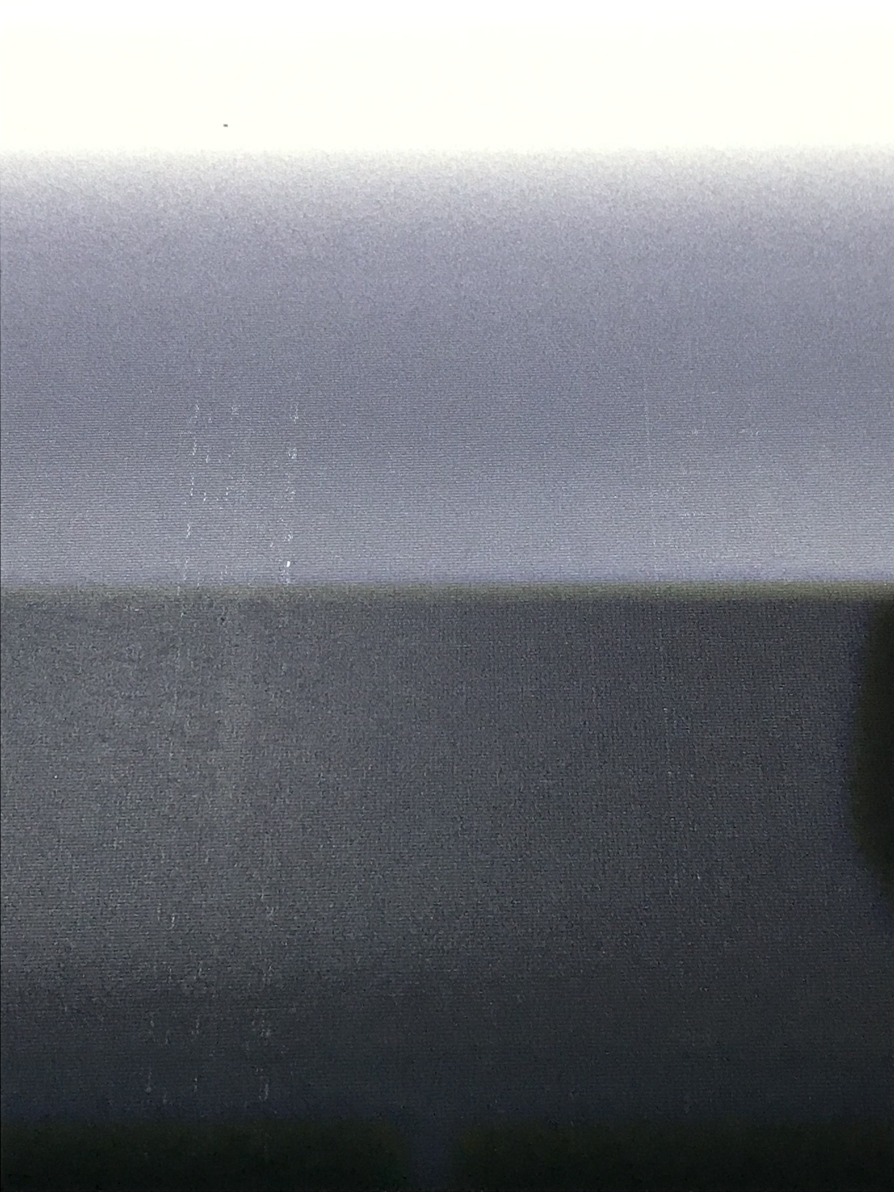

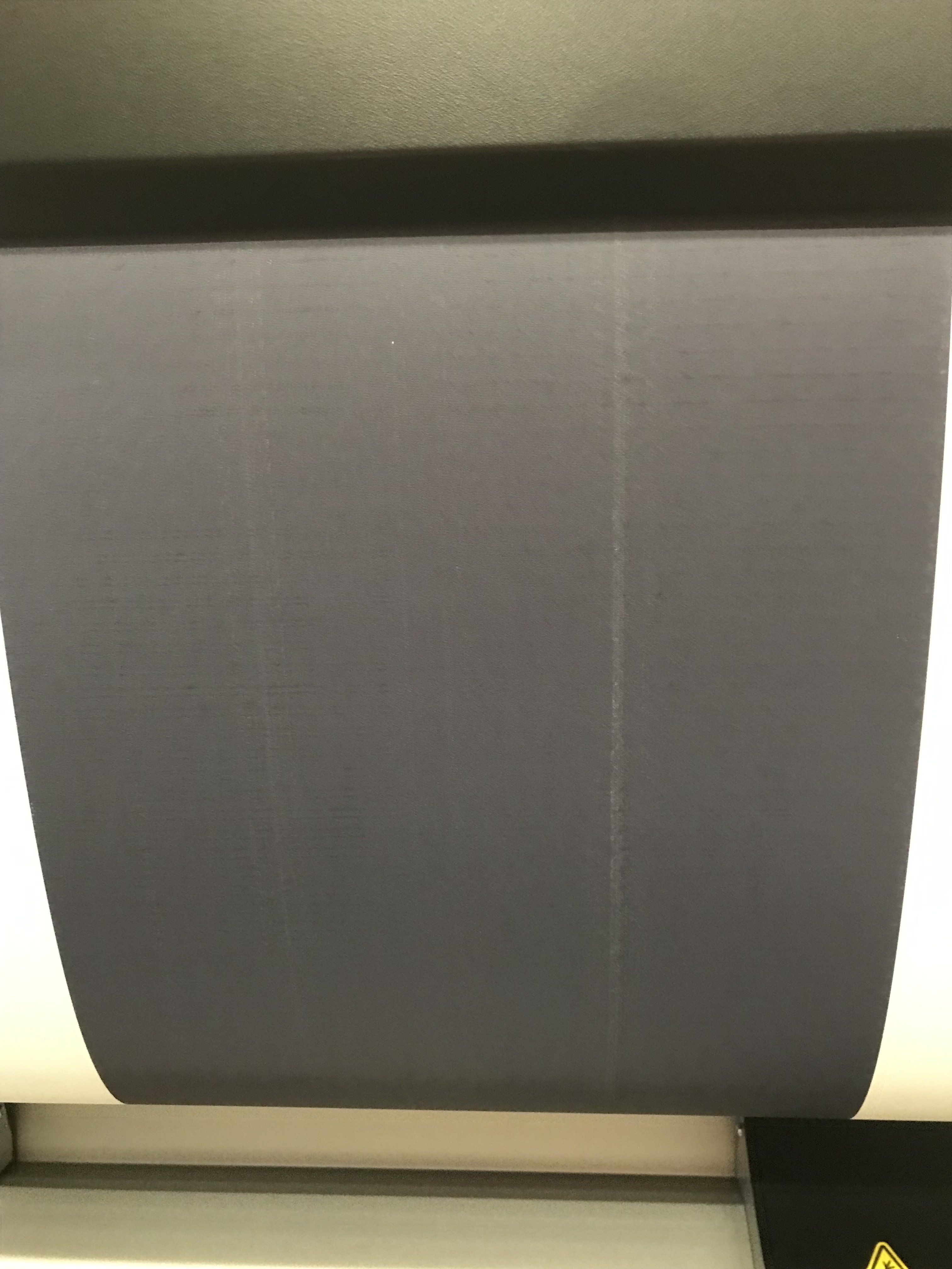

So I have been printing a job on the 60" version of this material in 8 pass 110% ink-vacuum @50 and have had the ink scraping the leading upper edge of the curing unit. Hp said to lower the curing temp from 195 to 180 which helped until I got to a dark section with full ink load.
Does anyone run this combination and what have you found ? I'm half way through the job and cant change the profile at this point. All I can do is go to a lower temp and try

Are you running it with no tension? Add some tension to the take up.
Tension is set to 8 but HP is adamant to not increase the tension saying that tension is like pulling the media along. Waiting to hear back. many prints were already produced just fine, its just happening with a heavy ink load across the print area
jeffdpia
Digital Print Orchestrator
Take up motor is being replaced, hopefully tension will return to the take up spool.
