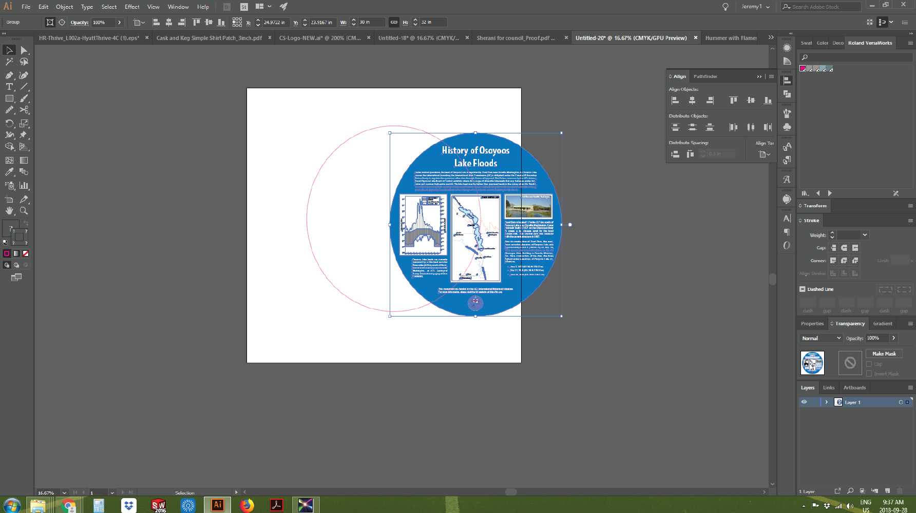

Sometimes when I add other artwork to Illustrator, in order to make a cut line, I go to center the object and it goes left or down, instead of centering.
Sometimes when this happens it is because there is a pixel somewhere that is grouped with the object in question.
I have made sure that I am only selecting what I want centered.... still the object goes left or right.
Has anyone else had this issue? Have you figured out what is causing this?
Thanks
Shep

Does it happen when you change the Align property to "Align with Artboard"?
I have tried both Align with Art board and Align with Selection. They both do it.
Even more interesting is that if I press align twice... it will go right twice. It should realistically stay in the same spot when you click align the second time.

Wow, that sounds bugged. Nuke it and reinstall would probably be my next step. I can typically get a fresh install within an hour while I'm working on other stuff, but I'd understand if it wasn't an option. Hopefully someone else has an idea. I'm pretty sure I've seen that problem before, but I can't think of what caused it.

I could do that, however I have had this issue with different computers. Its always when I place pdfs.

It is a clipping mask because that's what his control bar shows, so there's definitely clipping mask around. That shouldn't cause it to keep jumping to the right every time he clicked to align.
It didn't change anything for me but you could possibly adjust this setting back to center.

I tried it, really hoping that was the issue. But it still does the same thing. My solution is to save as a png. Its not a huge issue, I just hoped someone else had figured this one out. It is rather annoying.

This is one of the longest running and most annoying bugs in Illustrator. I've experienced it for years, on many computers.
I've never determined the exact cause, but it seems to always be an issue with complex objects that have clipping masks, and a few times I've thought there might be a connection with hidden guides inside the object.
The solution I've found that usually works is to ungroup the object and/or release the clipping mask, then re-group or reapply the mask. Takes 2 seconds if you know your keyboard shortcuts (Ctrl+G/Ctrl+Shift+G and Ctrl+7/Ctrl+Alt+7).

That’s what I do. I ungroup, delete the mask, then group again. That’s why I asked if they could supply the pdf and I’d try that to see if it worked, but they never did.
