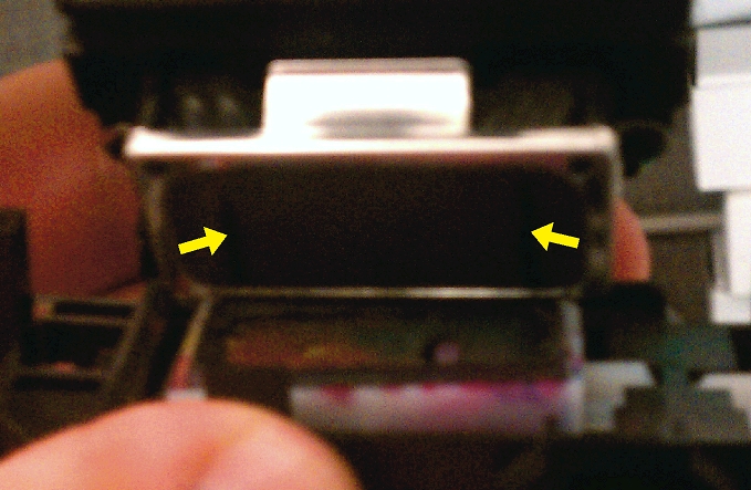

Do you guys see the size difference between the caps? How can the company that makes my printer sell me a part that doesnt even work? The cap doesn't even seal the head. The head just hangs over the side of it!
Stealth Ryder
I took a look at the Color Head and a Cap Top of a 38" FO printer. Notice the lines I made (Yellow Arrows point these out), this is the last row of nozzles on either side of the head. Compared to the Cap Top it clearly shows enough room/space to cover all the nozzles of the Print Head. It is close, I will give you that but if adjusted correctly The Head will seat properly on to the Cap Top which would pull the correct vacume while the pump in energized producing proper ink flow...
As for who makes the parts and where they come from, I don't know and never had a reason to question this... I do know that when I install the parts I get and make all needed adjustments to the machines they do work consistently with little to no call backs...

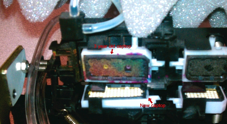

Stealth Ryder
I compared a 3 year old Cap Top (had it on my desk for I know at least 3 years) to a brand new one I pulled off the shelf... They were identical...

My new ones dont cover the nozzles on the head. Not comfortably at least. Still waiting to hear back from signwarehouse.
