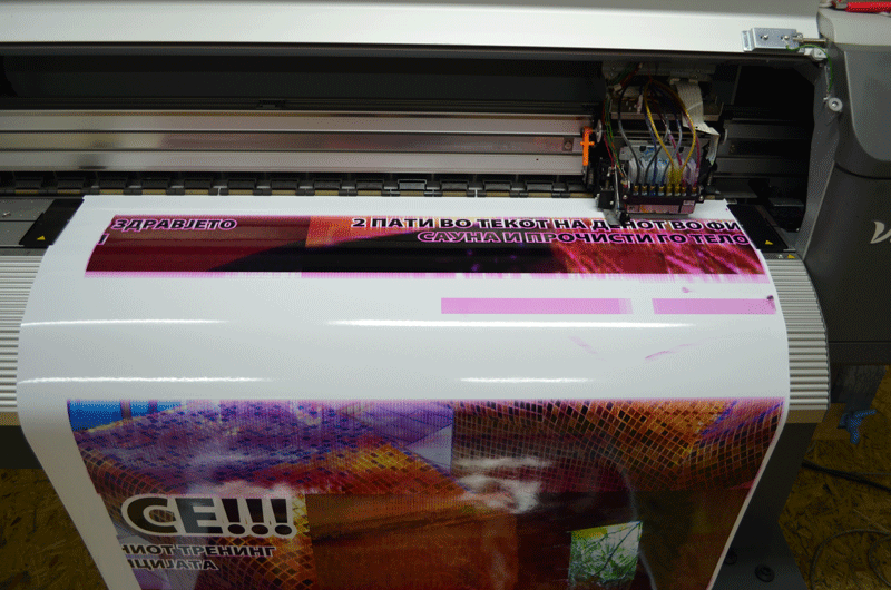

After all this work the printer star to print correct. I think that i solve the problem but my happiness end after 3 m2 when i receive something unusual which i dont know what to do. (In the past i like this printer a lot i think that i have the best printer in the world but like time pass i start to have a lot of problems and now i dont know what to do.)

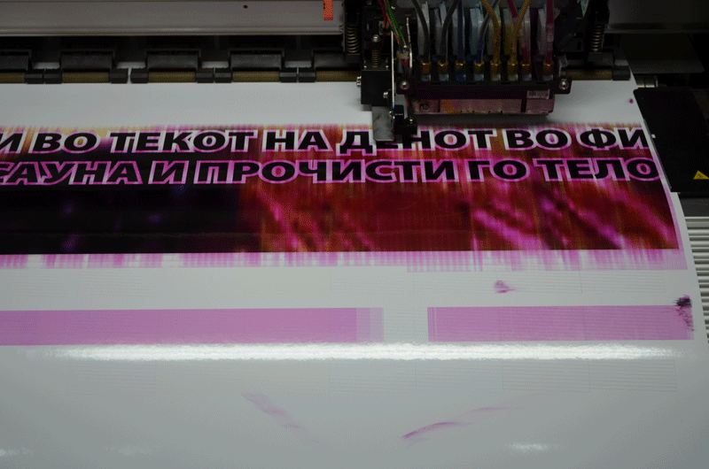

The printer start to print magenta from all noizel i dont know what to do so PLEASE HELP ME. Thanks in advance.

randya
The heater issue may be a thermocouple or heater.
Either could be separated from the platen and giving a false reading to the motherboard.
Magenta issue could be bad head or head cable.

The nozzle check is not correct you will see that in the first picture.
The first Chanel that is next to the white cable that come to the head is not exist the other are ok but i have magenta line across the all nozzle line.

randya
The head being out of position will not cause magenta to fire continously.
That is usually caused by damaged head, or head cables.
Can also be the head driver board.
vmishev
Thanks you Randya i find the problem the head cable was damage totally. I fix the cable and now i dont have that error. But i should check everything.
