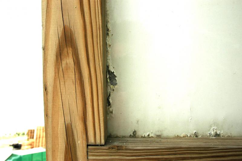

Alumilite is too flimsy and dent prone to just stick between to poles. I always end up framing it in with edge seal if it touches treated wood. Is there a better way?
note: corrosion from copper sulfate treated wood
