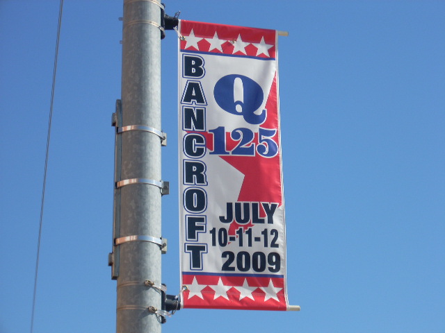

Attached is an image of one of the existing banner.
What is this cloth type fabric called??
is it sunberlla?

Our sunbrella looks stiffer than that, could be because with no bottom support and many years in use all the flapping softened it up. So I cannot tell you with 100% accuracy that is sunbrella.

I outsourced mine (since sewing is the only thing I don't do in house) to Quality Banner. They give a 5 year replacement guarantee which was a good selling point to the customer and they do very nice double sided printing with the pole pockets lining up.

Yes no bottom support. That what puzzeld me.. Cutting corners I suppose making one pole kit work to do 2 banner? CLEVER.. They do flap in the wind some but look good.
