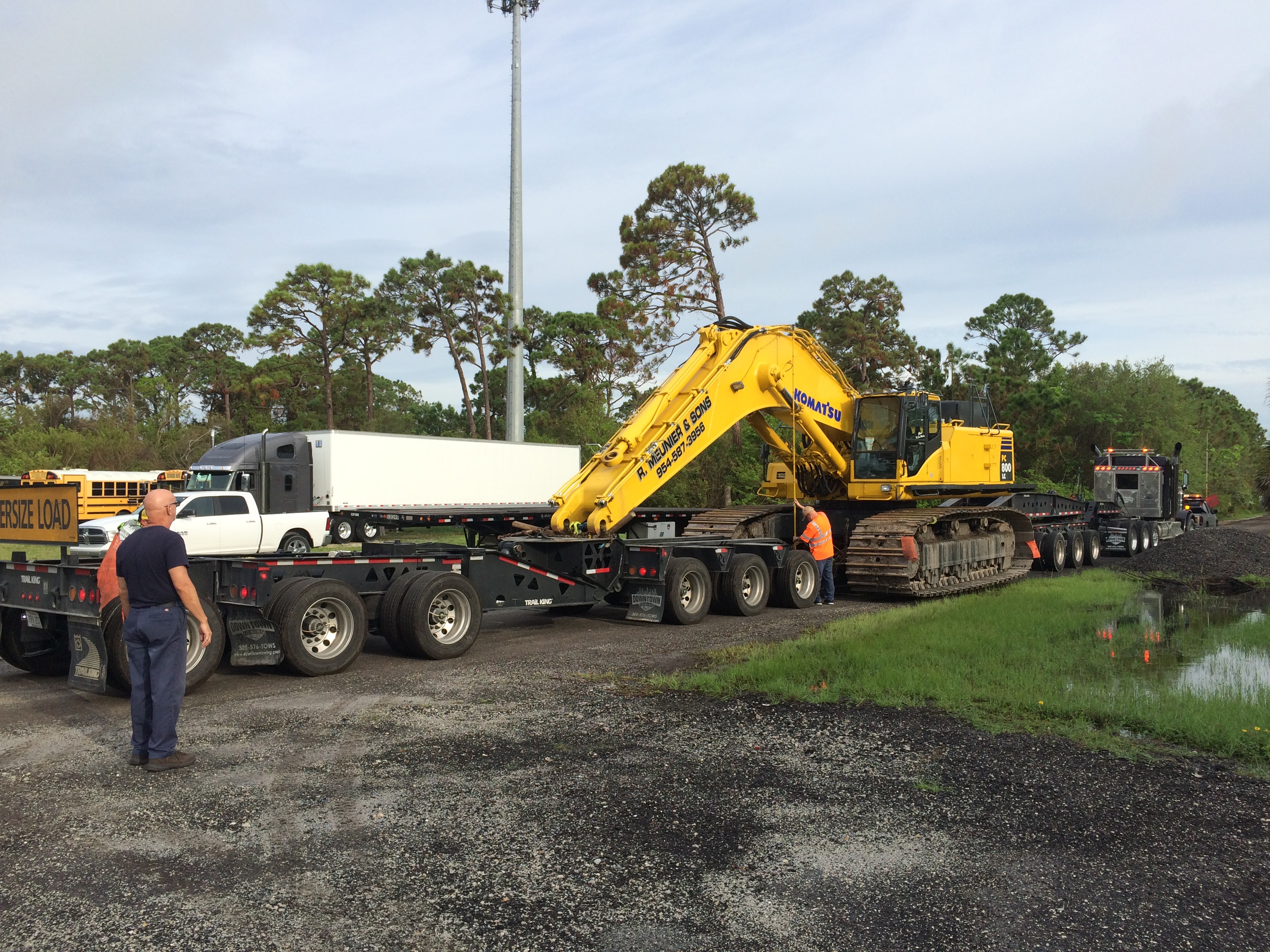

Get a real machine. This one has a shear and concrete muncher
