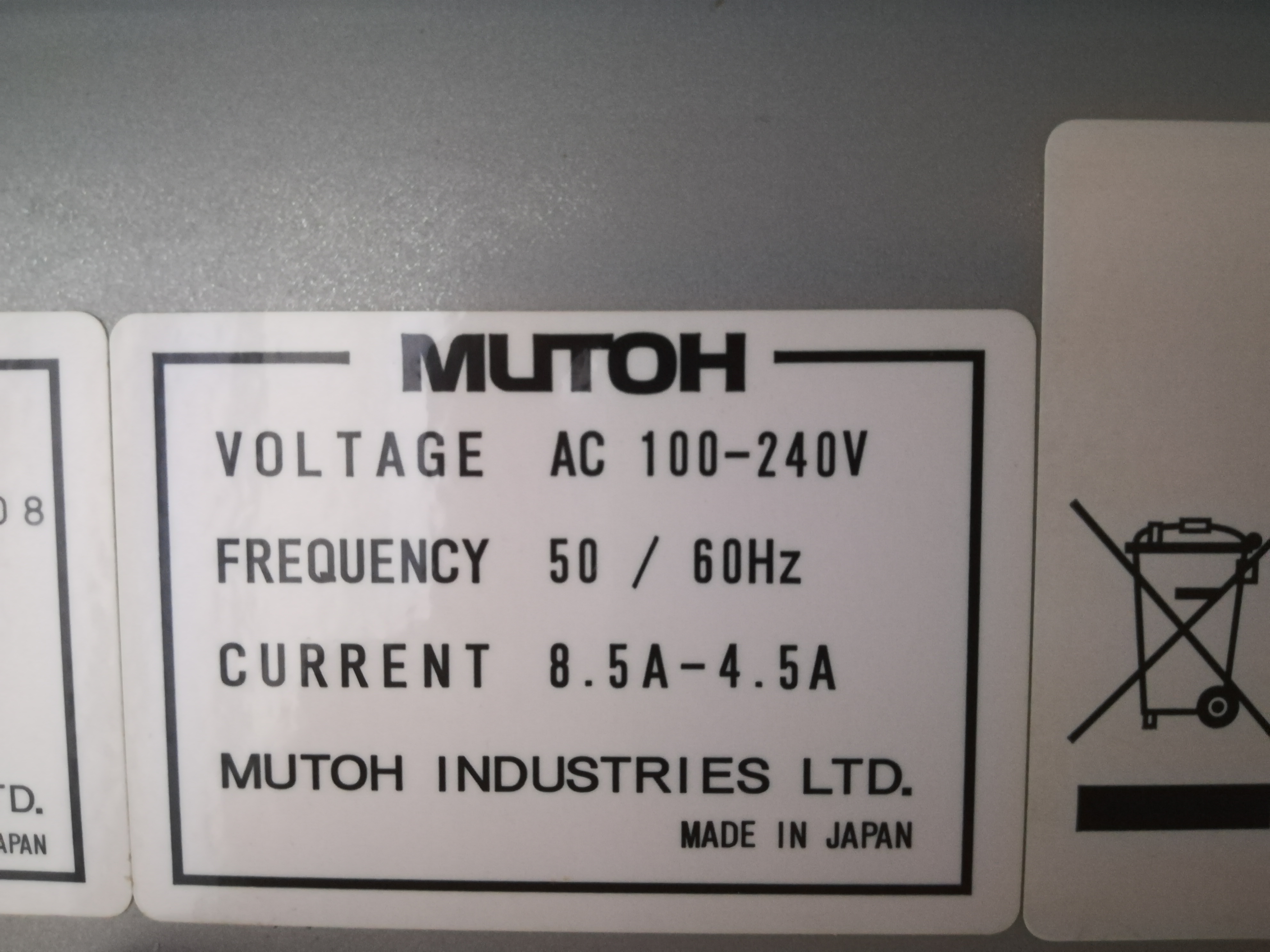

Look in the back of the printer, where you have the power connector. You have a sticker that says the working voltage. If it's from 100 to 240 volts then you don't need a converter.

Hi
yes it say 110v-240v on the same said sticker at the back. So i can put a 110 power cord and it would work without having the change the power board?
