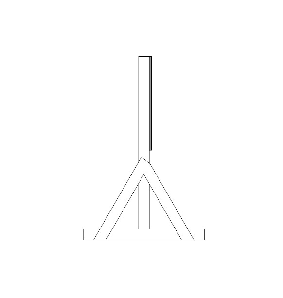

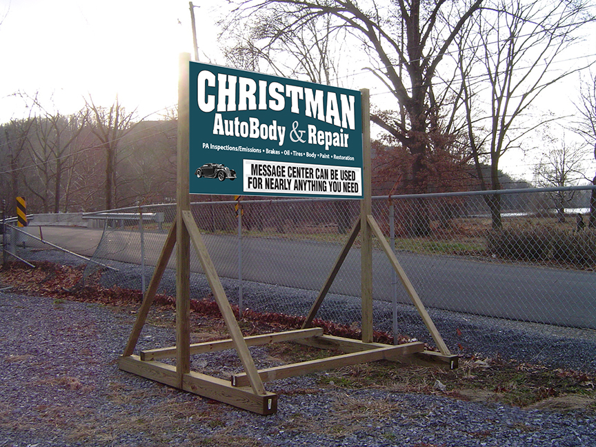

This is how we make them. We use 4" x 4" Treated wood. They are quite stable. But some still choose to use sand bags as well.
  • Origin Bank - Project Sign - 3D ISO.pdf
