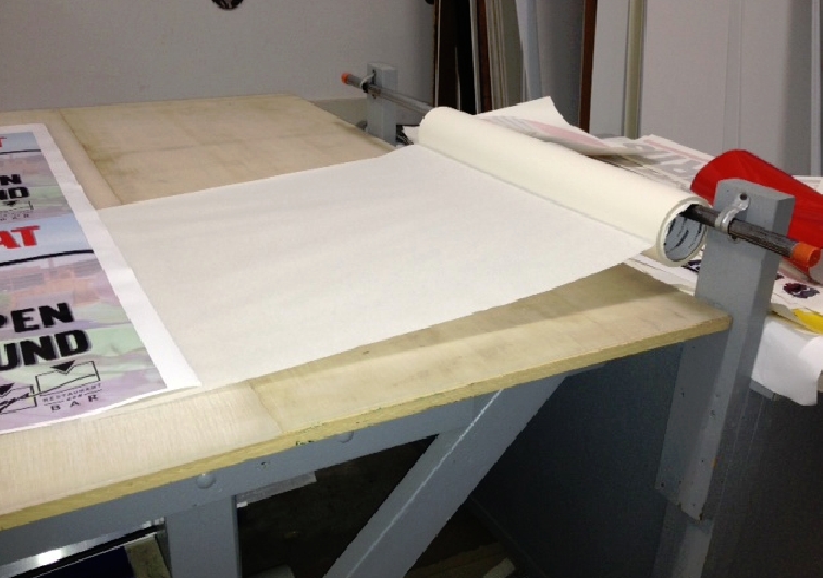

tsgstl
You don't need anything fancy
scrap 2"x4"s a pipe and a couple brackets
if your image is too big, mask half turn around and repeat
P.S. A good table is very important, mine is 5'x12' and can hold 1000lbs easily

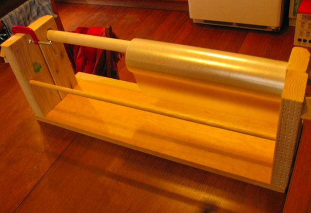

grabutty
Went a little more crazy with this than I needed to, but...
it works great and was a lot of fun to make.
THANKS everyone for all the good advice!
