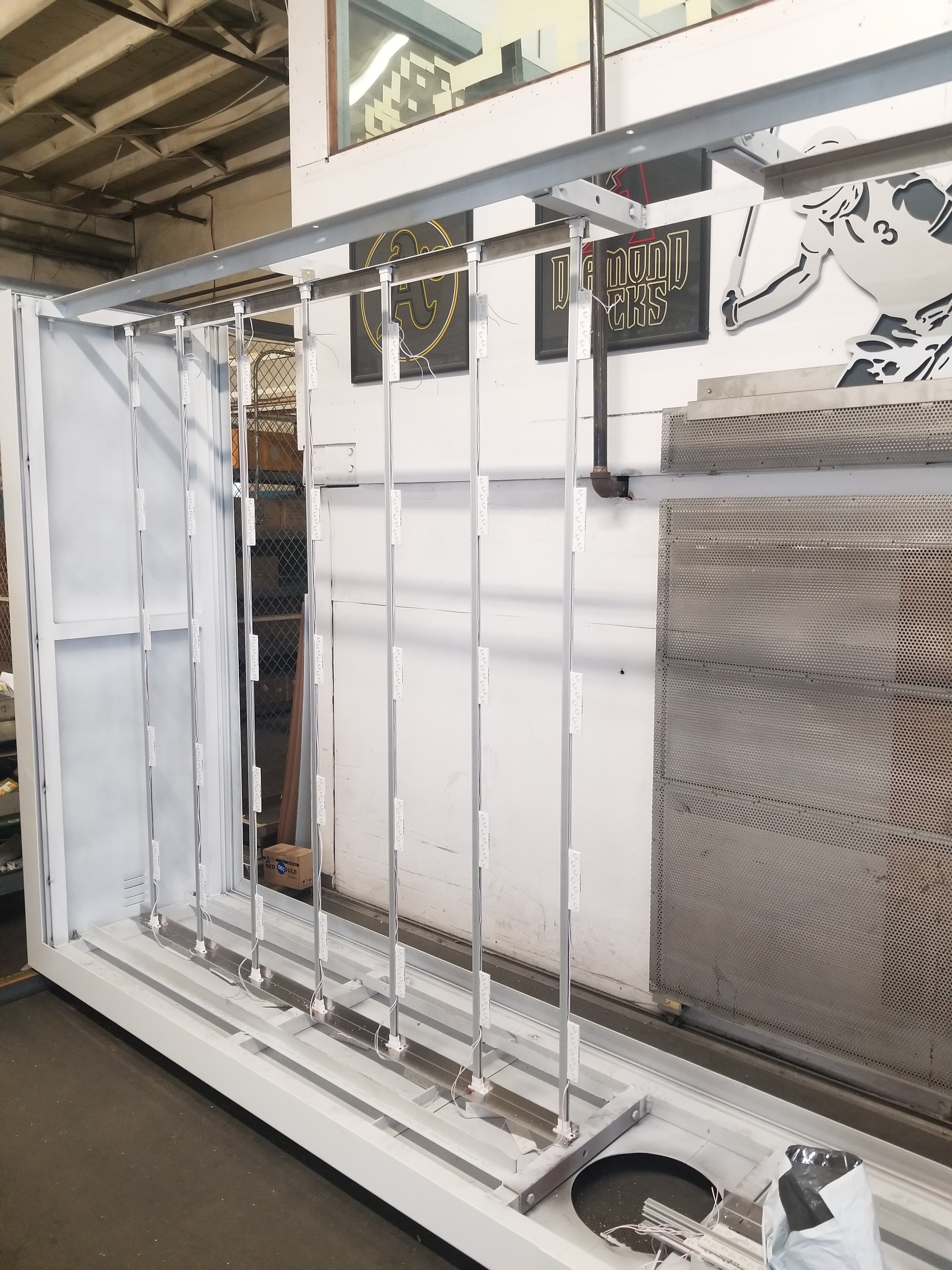

How deep are you doing the cabinet to slide over the existing pole, will you need a stub pipe. Is it going to be led or lamps. We move everything to led. Here is one we are installing the led bars ( AA LEDs in Cali) this one is going to Spring TX.

Hot Dawg them look like some fancy light sticks. I'm assuming they are either worth it, or they are faster to install as opposed to the GE/Principal sticks? At first I was going to ask why you didn't use the last module laying in the bottom of the cabinet, but from the looks of it, this is a two part sign, and you off set them so they wouldn't cast a shadow from the braces holding the two cabinets together, am I right?. So now the question is who pre-cut all of the runs for this, and who is going to pay for the 14 modules that will be shelved and never used? Also, do you plan to add angle between the saddles to guide the pole/stiffen the center so it doesn't sag? Just curious.
We used all of them, specially Principal but they didn't cut it the last time, that's why we brought these in. The manufacture cuts to size, but because we are stacking them we left a module for the middle section. Not sure about your last question but I'm sure we have something there.
henryz
I see. Did the principal sticks not hold up or just not bright enough?
They cause too many shadows even when using their specifications for spacing and depths. The modules we went with are 6watts ea. Super bright and even lighting on this 14' x 14'. Here is a 16ft x 36ft df cabinet with the same led.
