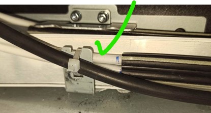

pkeshtgani
Also I don't believe the white clip is supposed to be there.
Sent from my SM-G973U using Tapatalk
your image is correct but the OP picture is not the correct setup. this is what I was provided.
