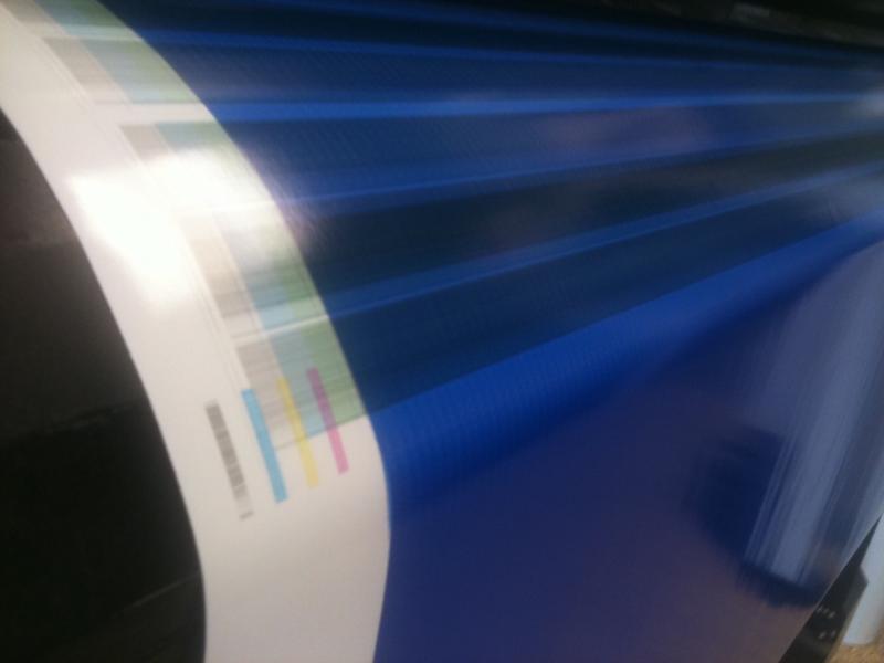

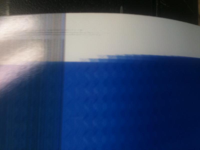

I am printing full coverage and after 4'-7' it starts shifting to the left. Then it starts printing lines off the page.
I worked on this everyday since last Saturday and finally by Thursday afternoon I had to put it aside and work on other jobs. It seems to be a problem with full coverage. Thursday and Friday it ran all day long doing everything from banners to decals to yard signs at least 100' of vinyl no problem. I thought maybe it was a file problem so I have printed everything you can possibly print. I have used every profile every setting. All test prints come out perfect. I have wasted at least 100' and of material and 30+ hours on this problem. Is it something going out? I just don't know what other direction to take. I have never had this problem since I have had it in 08.

tsgstl
Thanks man I'm driving back up to the shop to try that. I have cleaned everything else but not that.
Letterbox Mike
Just make sure you only use a lint free cloth lightly dampened with water, distilled water if you can get your hands on it. DO NOT use any sort of solvent or abrasive cleaner on it.
tsgstl
Oh man thanks I would of searched before I did it but if I couldn't find it I would of used a cracked open cleaner cartridge. I have distilled water right here. Always have lint free clothes. Thanks again!
goldlight
service engineer
encoder scale
ur encoder scale is shifted to right lose all scrow which hold encoder scale movw the scale to right posoition and fix the holding screw u will see the result>>>
:clapping:
tsgstl
it was the encoder strip actually. I cleaned the strip with distilled water like mentioned above and it has been perfect since. Thank You
