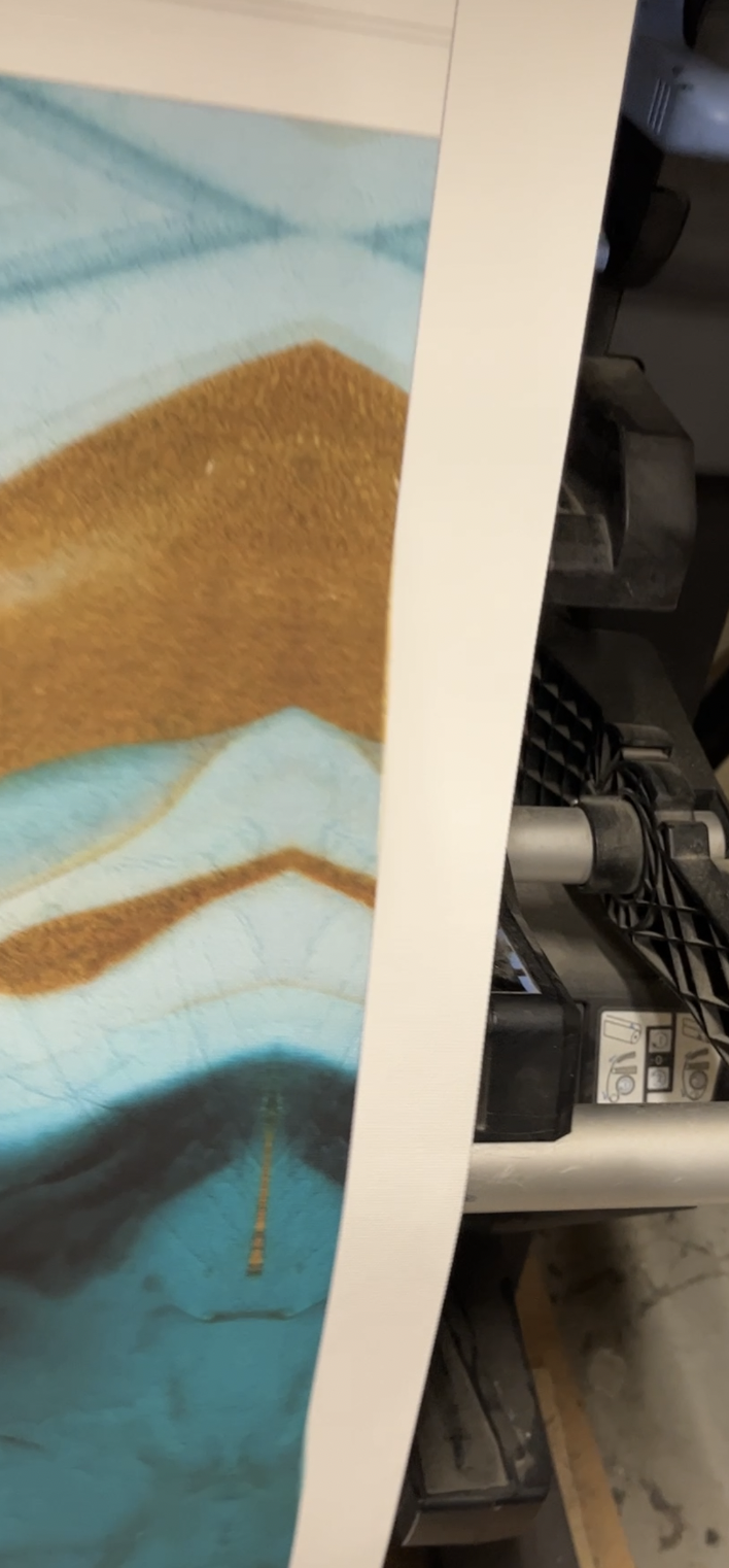

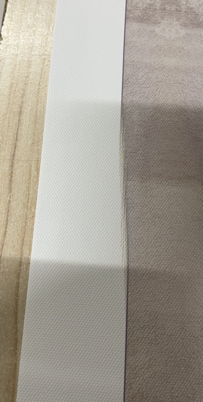

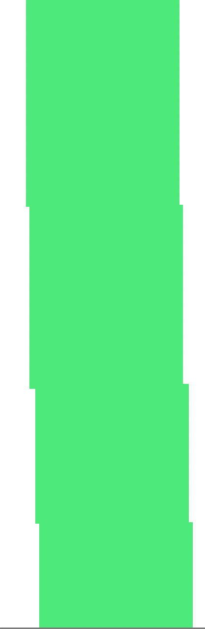

A couple of times today, and once during the week, we had the print almost swerve off its path
Our prints have an equal gutter on each side of the print
The roll remains straight, it is not unwound uneven, but for some reason the print seems to be drifting off course
Almost in steps
like a small swerve, before resuming a straighht line on a new path
and then the same again
If you see the attached images
The result, was that what was a 2cm gutter on each side, had become almost 4cm on one side, and 0.5cm on the other side, after several metres of printing
Any suggestions what may be causing this ?
Its only on one of our 5 machines
Ive tried to show it in a diagram, and also a couple of shots that show how it swerves and drifts
