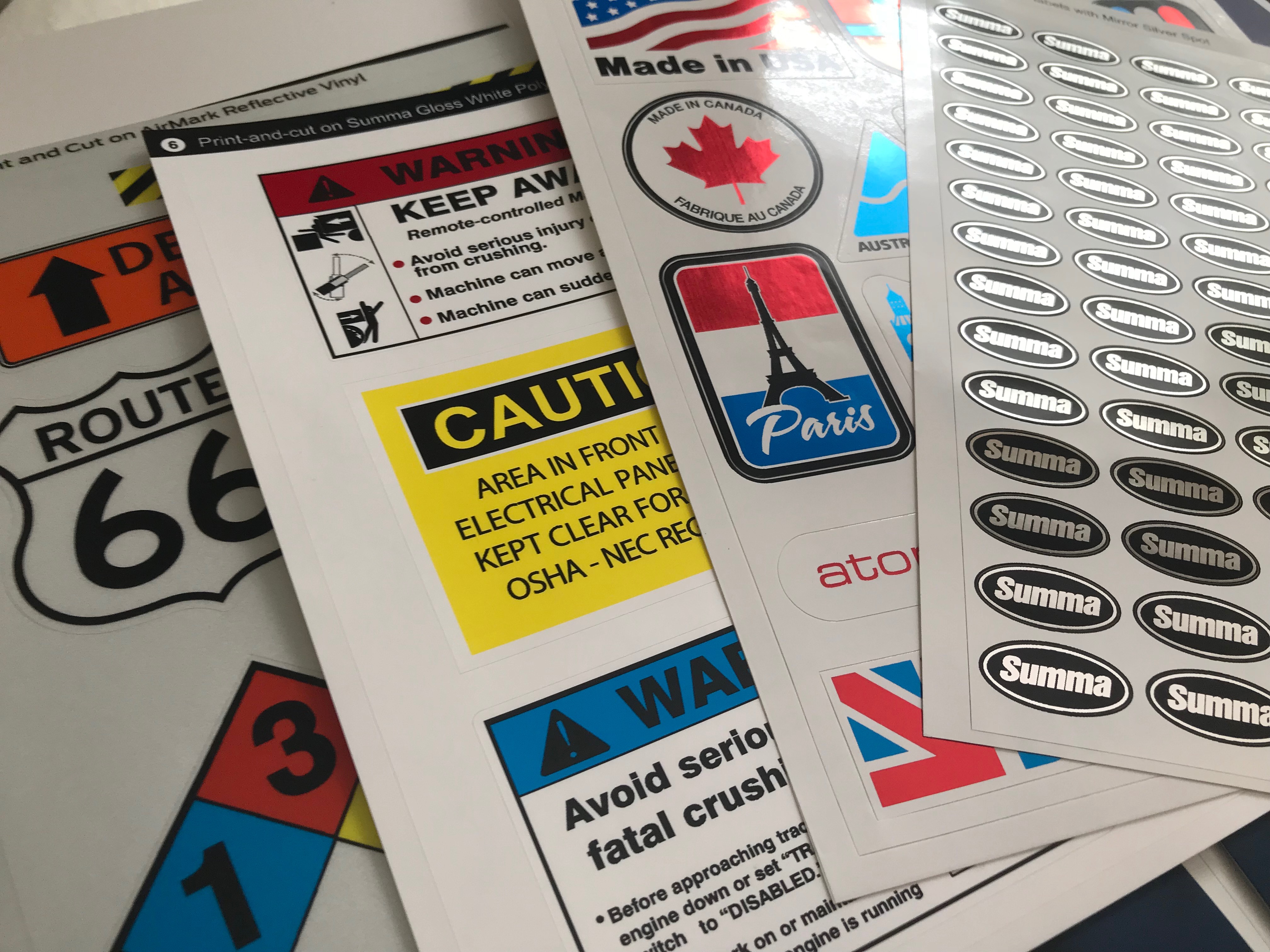

  13. The Raven
    The Raven New Member
    16
    5
    3
    Oct 4, 2017
    Winter Park, FL
    I attached some samples of stckers from a Summa.DC4/5.
