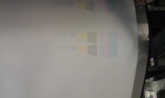

    started printing this morning and print looked like crap. didi a test print and hardly any nozels are firing. looked at the heads and I can see rings on ink rings on all the heads. Does this mean it didn't park in the capping station over night? What should I do, already did a normal clean and it did nothing. should i soak a swab with cleaning solution and hold it to the print head??

    Please POST pictures of the TEST PRINT

    after just a normal clean, the test print was perfect minus 2 cyan dashes that have never fired on a test print. Just doing a manual clean now and going to press a swab to the heads. Never done a head soak, how is it done?

    haha, you cant see in the picture but there is a horible looking greenish print before the test print.
