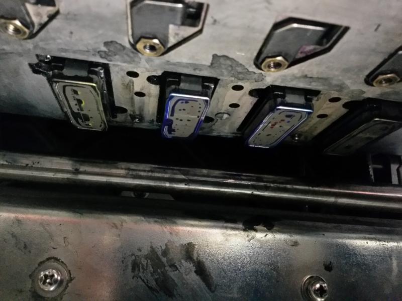

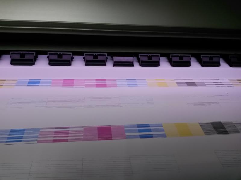

Hello everyone, does anyone know the ansver all printhead leaking after cleaning cycle. When printhead clean up menaul and remove the hose from the pump one time is al Ok, and no drops. I changed pumps, dampers, vipers, caps and manifold. Thnx

good nozzle test without connected pumps, and bad with pumps

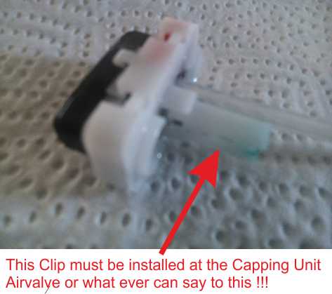

At the captop is a air nipple....working follow....Cap top close the head.....sucks ink aso.....cap is close...the capping unit lower a little bit but the cap is close and the airvalve (nipple) opens and pump sucks the rest of ink from the cap top.
If the Airnipple (valve) clogged or dont work correct is always ink at the caps so the ink always under the heads after cleaning aso....
check if the long white plastic installed at he capping unit so they correct working.

new cap top says not thats correct working.....in your first picture you can detailed see thats not ink dropping out from the PH but you can see around the PH thats ink overflow from the Captops so the captops not clean up...always stay restink in there.
to check the captops correct working use a syring and you become negative pressure....1st step fine......after this you can lower a little bit the capping station thats only open the valve (not the close PH position) from the caps and suck again.....you must become air (no vacuum) on the syring.......thats you problem !!!
if caps close and become no vacuum (ink at syring) is the captop Valve open or demage...so its not working correct !!!
New or not check it and you will see your problem !:notworthy:

Thank you all, I finally took off new Cap's, clean up old and everything is OK. Wunder Thanks for the idea that the new Cap's can be bad.
