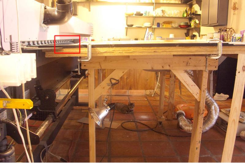

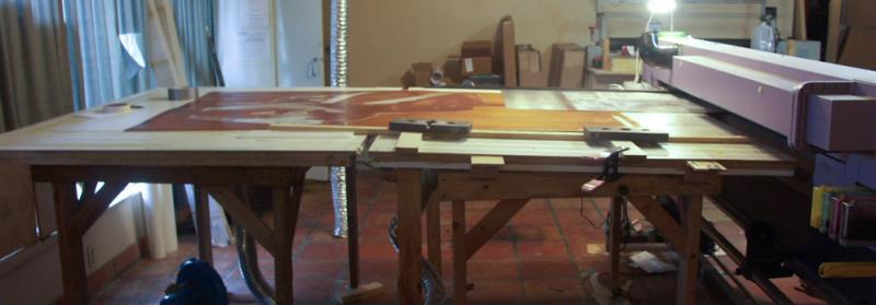

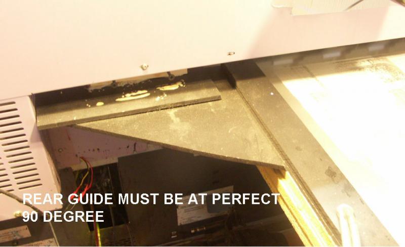

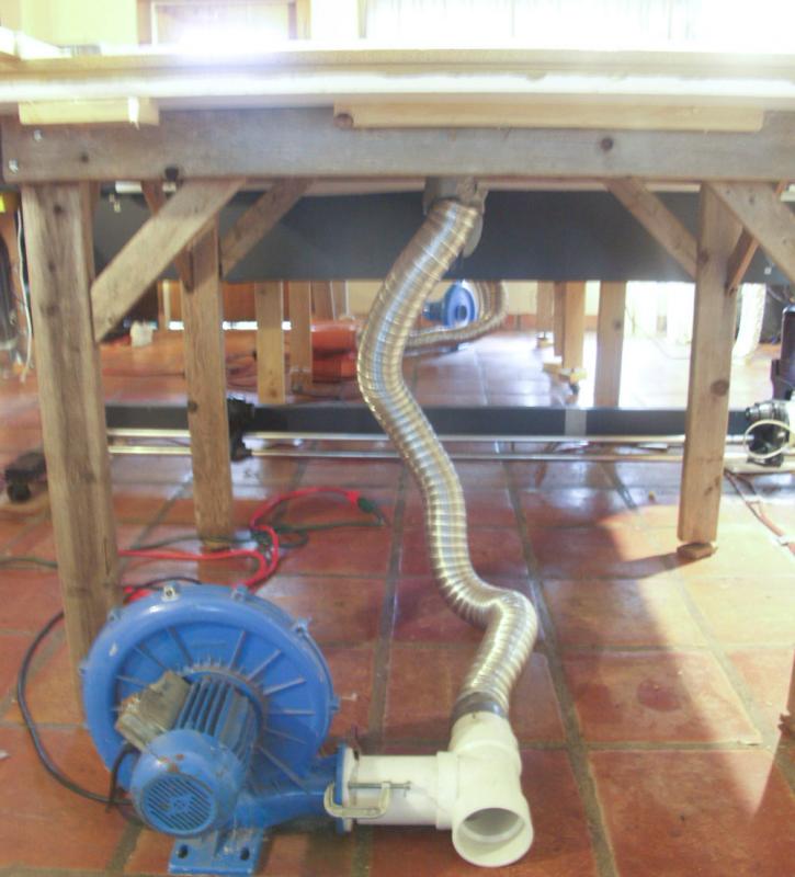

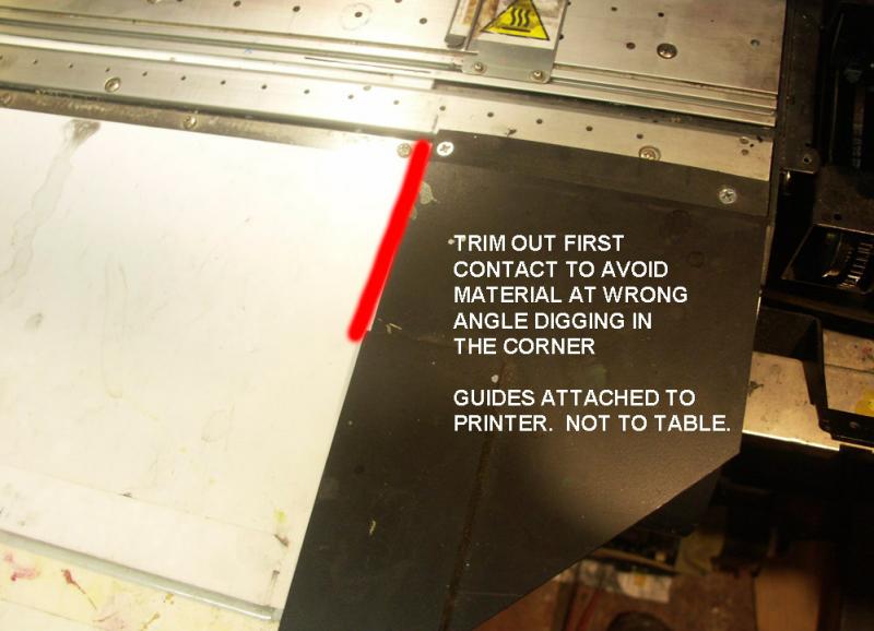

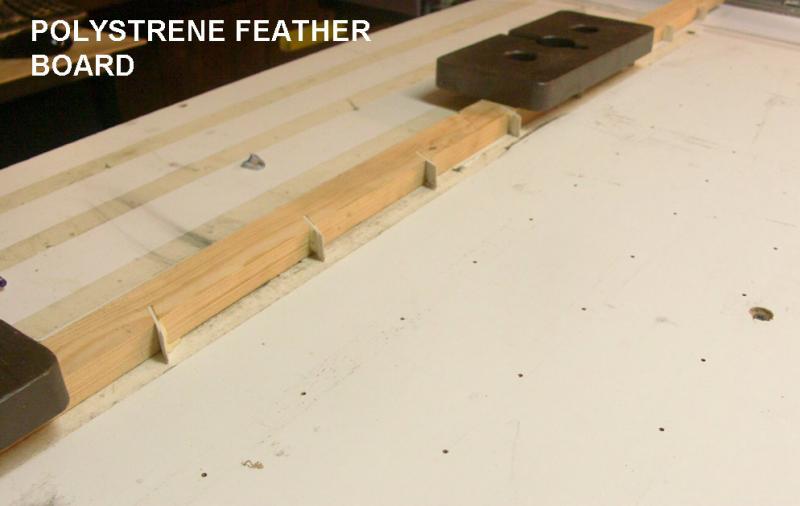

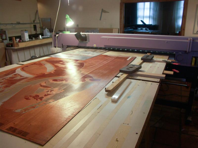

hey guys... yup. printed exclusively flat .040 aluminum, and veneer on my flatbed jv3 for about eight years straight. you'll need to build two air (air hockey style) tables with some guides and feather boards. it works quite well for 4x6... a bit iffy past that. i've printed as big as 5x10, and 4x12 but would keep that to artistic purposes rather than signage.
all this was done with the jv3 (and a lot more)
http://www.flickr.com/photos/alldredge/sets/72157627000489887/
i'm lucky to have an early CET 6x10 (16 head) flatbed now. getting used to the workflow and doing my mods to it currently.
here's what the rig looked like.

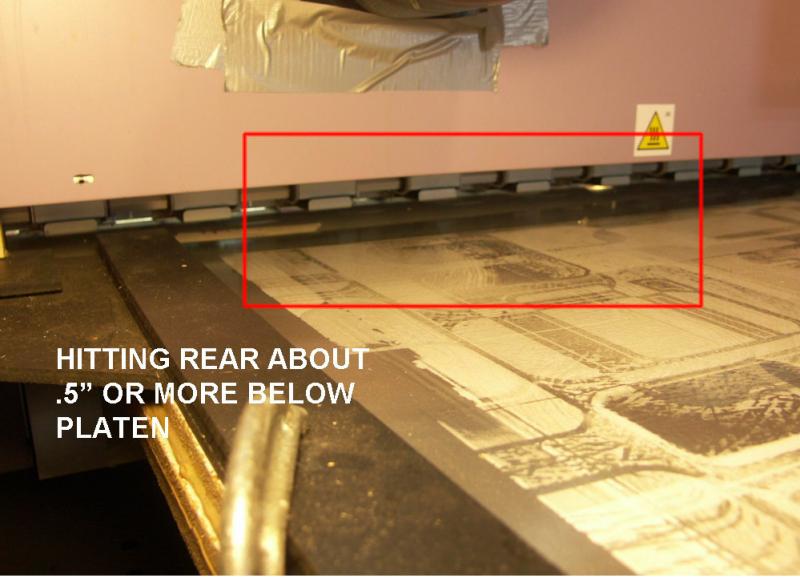

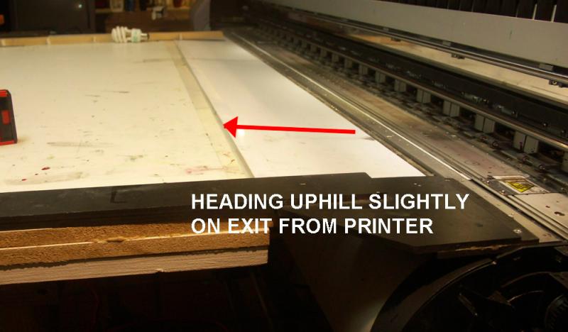

artbot
the secret is to have the material head very slightly down hill into the nip then exit very slightly uphill. this puts a mild reverse crown on the material. using this method, the sheet will be drawn through the printer (almost) without the pinch rollers down. straight through works, but not as well.
