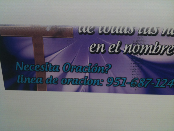

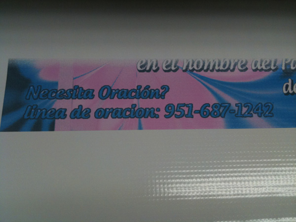

Okay, I moved the head up, and lost the tracking, but my colors changed significantly, the purple one is the correct color, with the tracking, the pink is bad color, no tracking:

Did you change the profile? My colors don't change that much when just adjusting the head height.
Also, try unrolling some slack from the core on the back of the machine when printing banner material, helps it to prevent from buckling.

Waittttttt, you don't know heater settings or head height yet?
New to printing? lol.
Head height should NOT alter the way color is laid down, atleast not in the way you're showing. Something else is going on here for sure.
I run essentially zero heat when printing banners, then let them dry on a rack.
I'd run a cleaning cycle, definitely keep the head up when printing banners, and unroll some slack from the roll when printing (and keep some slack in it). Colors shouldn't vary like shown just by adjusting the head height.
Def. run a cleaning cycle, then give it a shot again with the head in the high position. If the color is that off with the same profile & media, something is going on. Good luck with it, hopefully this will remedy the situation though..
